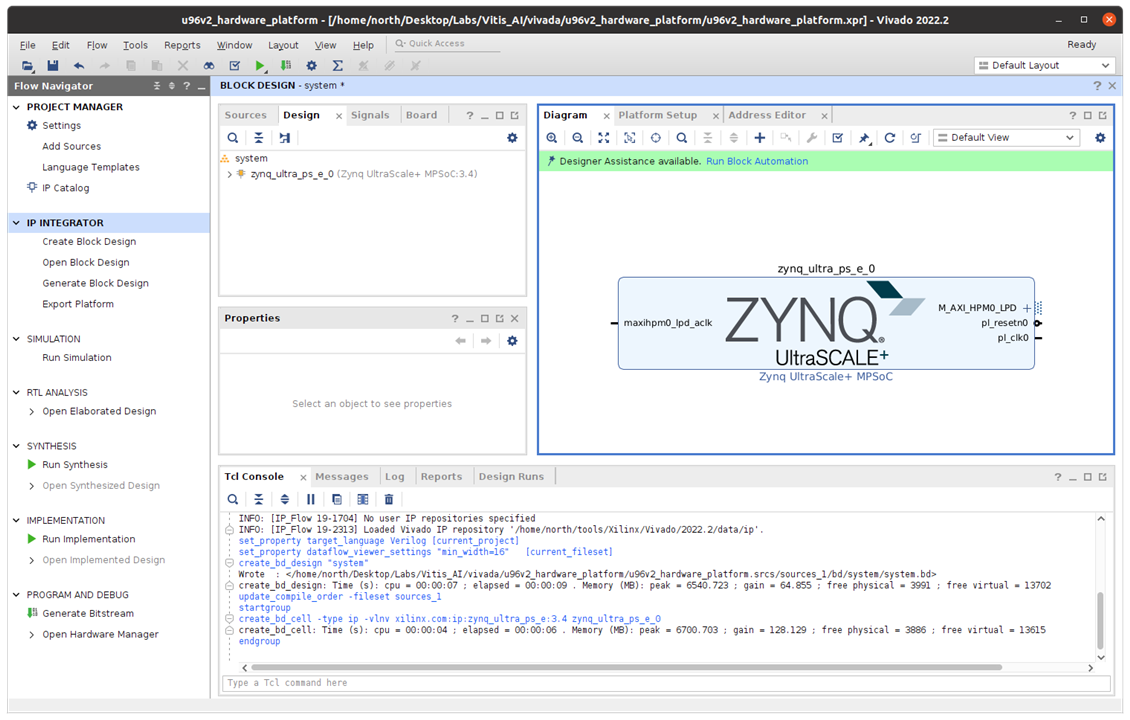

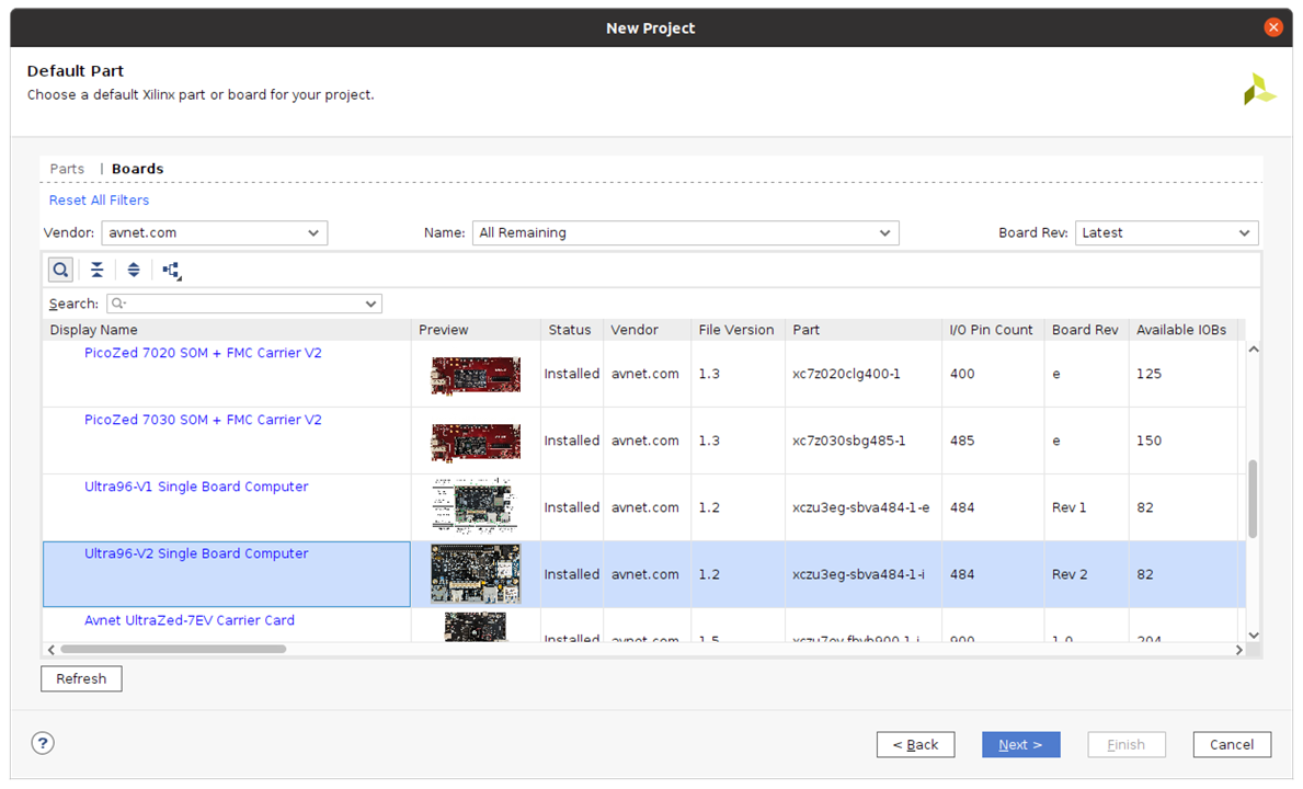

3 Create hardware design with vivado
3.1 launch Vivado and create new project u96_custom_platform
select ultra96-v2 board, the hardware file can be got from github in hdf format or just press refresh for latest available boards,

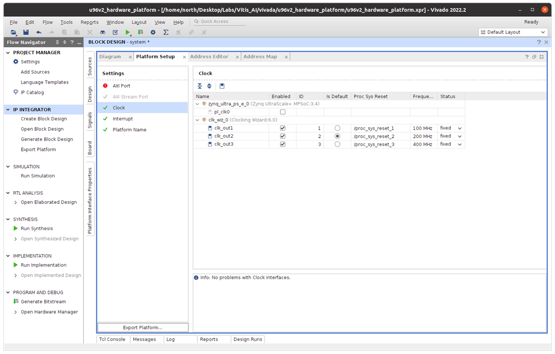

3.2 Create block design
add Zynq core- UltraScale+

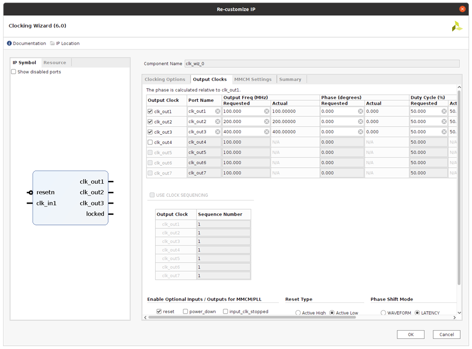

add the Clocking Wizard to the block diagram and
  • Enable clk_out1 through clk_out3 in the Output Clock column. Set the Requested Output Freq as follows:
    • clk_out1 to 100 MHz.
    • clk_out2 to 200 MHz.
    • clk_out3 to 400 MHz
  • set the Reset Type to Active Low.
add three Processor System Reset block with name proc_sys_reset_1, proc_sys_reset_2 and proc_sys_reset_3
Run Connection Automation,
Enable clocks for the platform,
  • Enable all clocks under clk_wiz_0: clk_out1, clk_out2, clk_out3
  • Change their ID to 1, 2 and 3
  • Set a default clock: click Is Default for clk_out2
Enable AXI HPM0 LPD to control the AXI Interrupt Controller
  • Enable the AXI HPM0 LPD option.
  • Check the AXI HPM0 LPD Data width settings and keep it as default 32.
  • Disable AXI HPM0 FPD and AXI HPM1 FPD

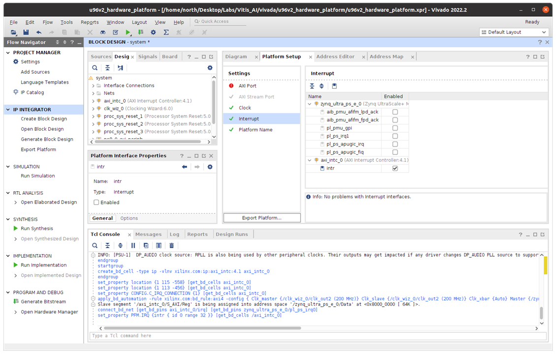

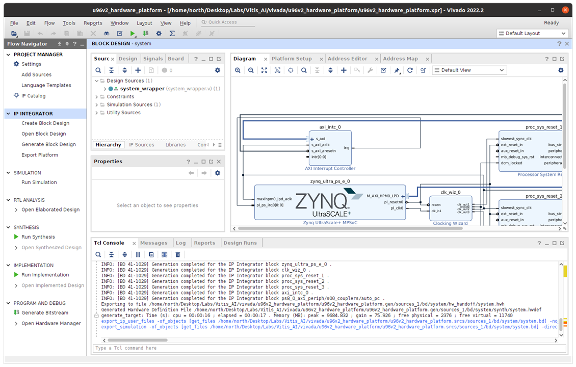

Add the AXI Interrupt Controller and change Interrupt Output Connection to Single so that it can be connected to PS IRQ interface.
Add the AXI Interrupt Controller and instantiated as axi_intc_0.
Run Connection Automation, and Set Clock Source for Slave Interface and Clock Source for Master Interface to /clk_wiz_0/clk_out2(200 MHz)
Here is IP design connection,

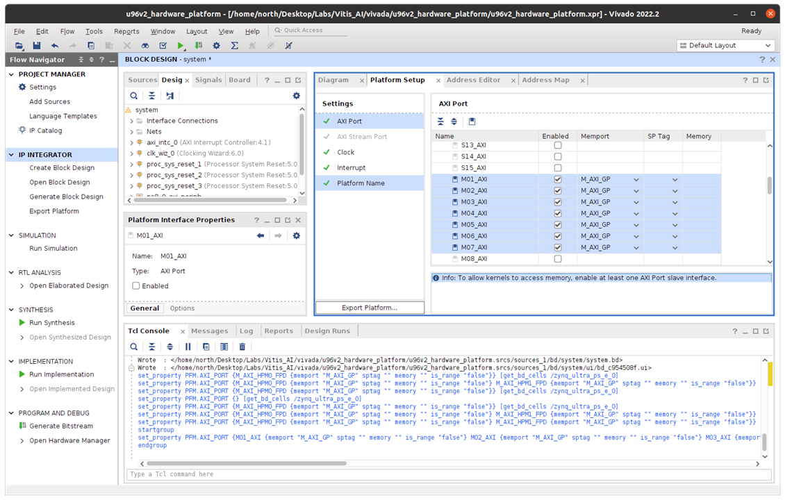

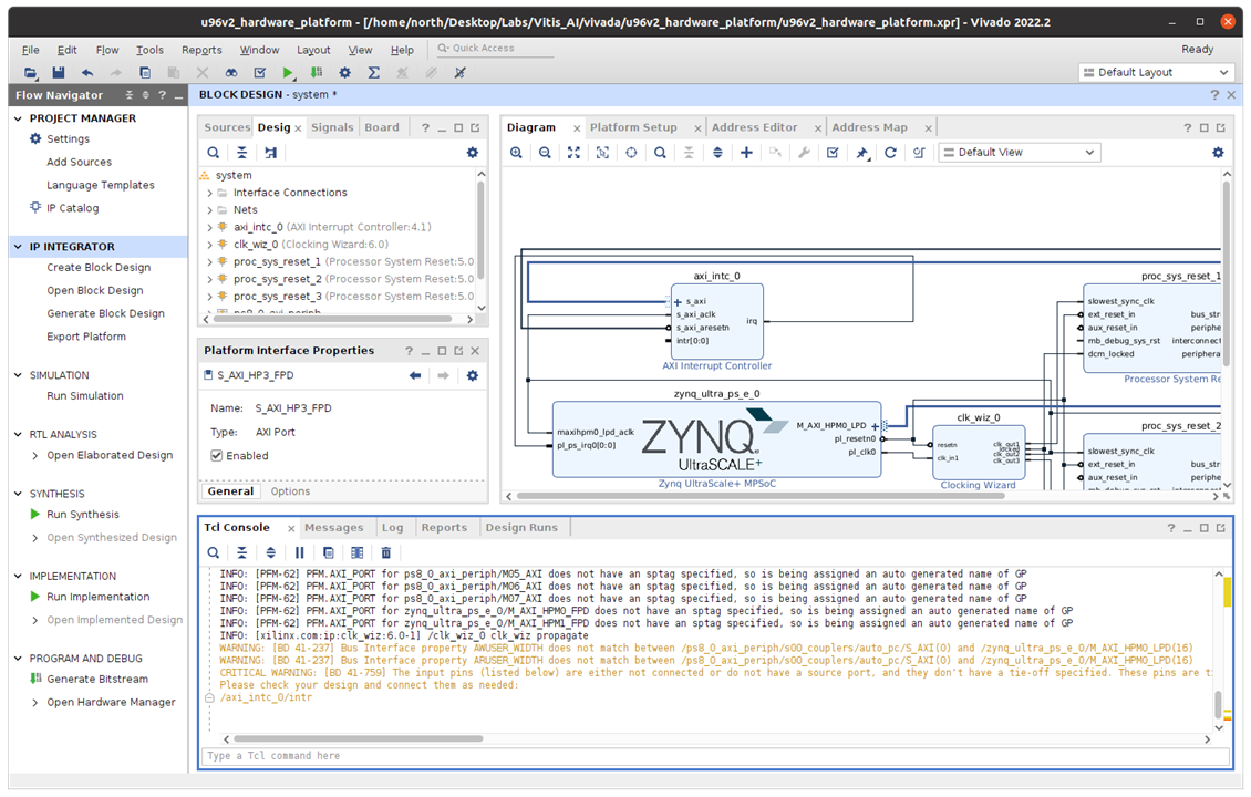

3.2 Enable AXI Interfaces for the Platform
Enable AXI Slave interfaces from PS to allow kernels access DDR memory,
Under zynq_ultra_ps_e_0, multi-select all AXI slave interfaces: press Ctrl and click S_AXI_HPC0_FPD, S_AXI_HPC1_FPD, S_AXI_HP0_FPD, S_AXI_HP1_FPD, S_AXI_HP2_FPD, S_AXI_HP3_FPD. Right click the selections and select enable.
Change Memport of S_AXI_HPC0_FPD and S_AXI_HPC1_FPD to S_AXI_HP because we won't use any coherent features for these interfaces.
Type in simple sptag names for these interfaces so that they can be selected by v++ configuration during linking phase. HPC0, HPC1, HP0, HP1, HP2, HP3.

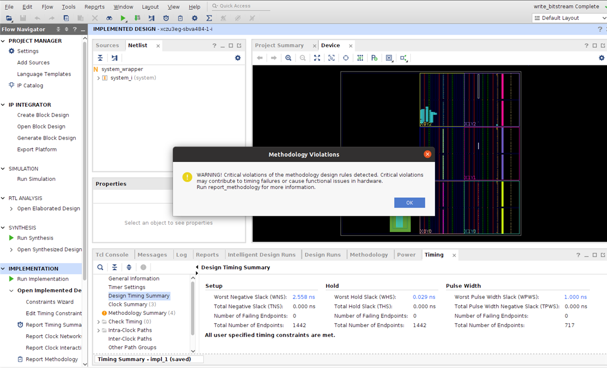

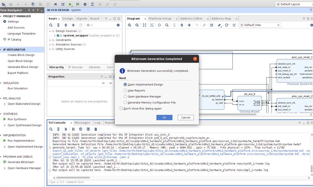

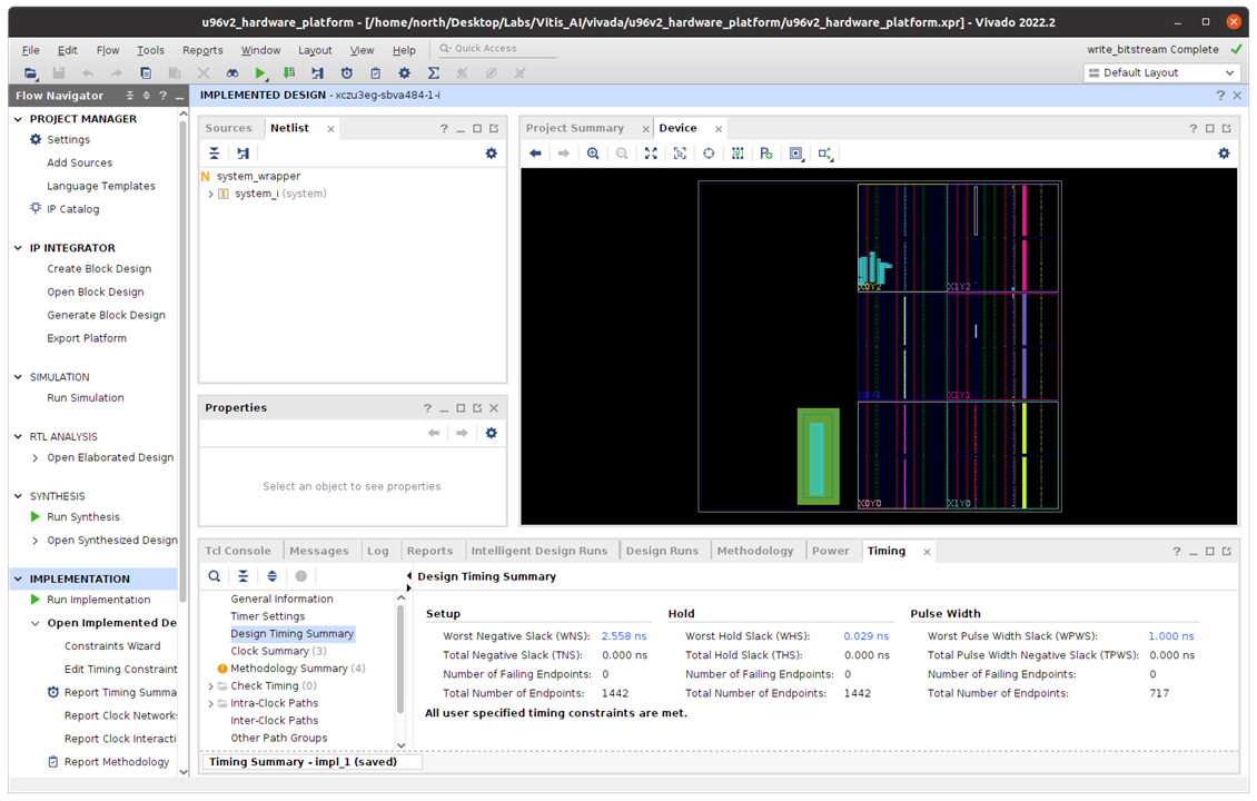

3.3 Click the Validate Design button first
Create HDL Wrapper...
Generate pre-synth design
Launch synthesis
Generate Bitstream
Now, explore the design, the GUI shows how the LUT on hardware design
Export the platform
with project name the u96v2_custom_platform_hw and choose output location,
Now, hardware design and output hardware design file xsa.

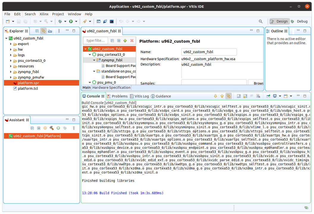

4   Create project with Vitis AI
Launch Vitis AI IDE and create new platform project
import the xsa file in psu_cortexA53 core
Generate boot components, and the project is created,
click the Build button to generate the platform.
Build finished

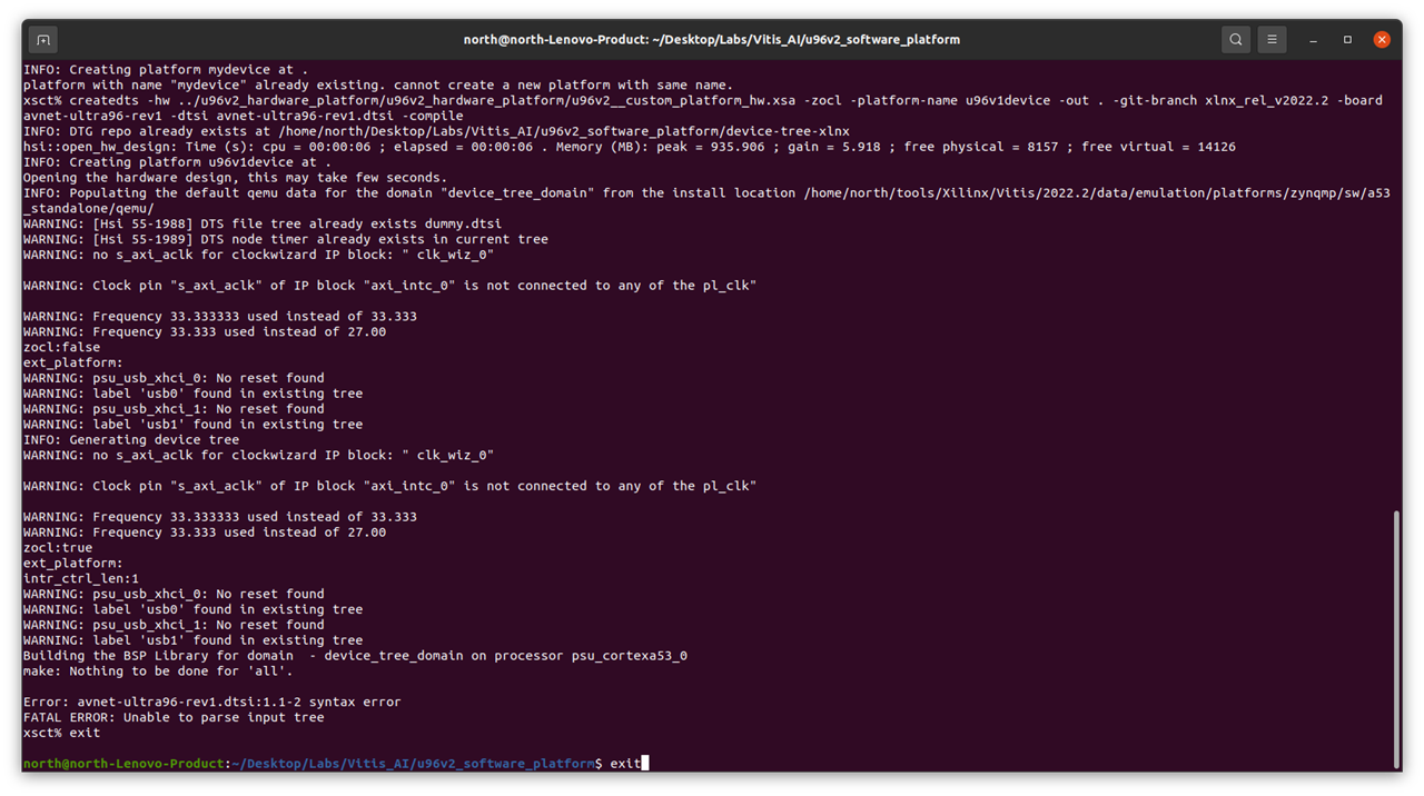

5   Create petalinux image with command XSCT

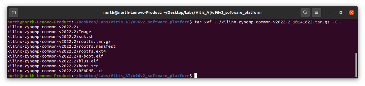

5.1 Download the common zynqmp file and unzip it
Type tree to explore the file structure, it is used as basis for boot and rootfs
copy source files to desitination directory
run sdk.sh to build the sdk
after all above preparation, command xsct can generate all neccessary file for petalinux image, it download libraries, device trees
xsct
there are some warning for files, during this process, until report device tree is error,
