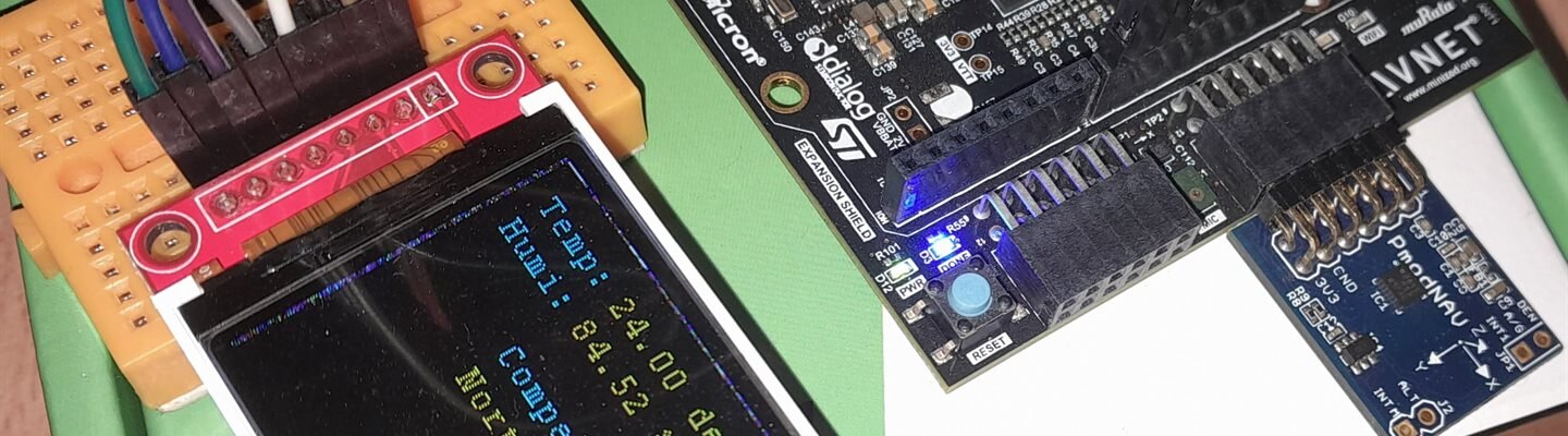

Now that we have come to the software side, its all about getting the application code right. The PL implemented peripherals are already memory mapped and only have to be called and referenced back as a part of this activity to give life to the system by reading sensors and seeing some colour on the TFT display. Here, the HTU21D and TFT LCD ibraries are used which includes fonts and styles for the display. I will post the full project file on this GitHub repo soon NavadeepGaneshU/Path-to-Programmable-III_MiniZed: Project files with blog links of exploration with MiniZed board on path to programmable element14 community contest (github.com)
 * Program for multi-sensor interface and display on 1.8 inch TFT with MiniZed
 * using the PL defined Pmod, GPIO and SPI IP blocks
 * More details and full source file at https://github.com/NavadeepGaneshU/Path-to-Programmable-III_MiniZed
 * TFT 	| MiniZed
 * Vcc 	| 5V
 * GND 	| GND
 * CS  	| IO_10
 * RESET| IO_8
 * A0	| IO_9
 * SDA	| IO_11
 * SCK	| IO_13
 * LED	| 3.3V
 * HTU21D pin maps to SDA and SCL of the MiniZed arduino header pins
 * Pmod NAV at Pmod 1

/* External file: TFT printing snippet from pmod_nav.c*/
/* print this on the TFT display */
GUI_DisString_EN(50,50,"Compass",&Font12,GUI_BACKGROUND,CYAN);
sprintf(compassbuf, "%s", str);
GUI_DisString_EN(50,65,compassbuf,&Font12,GUI_BACKGROUND,YELLOW);
/* End of External file: TFT printing snippet from pmod_nav.c*/
