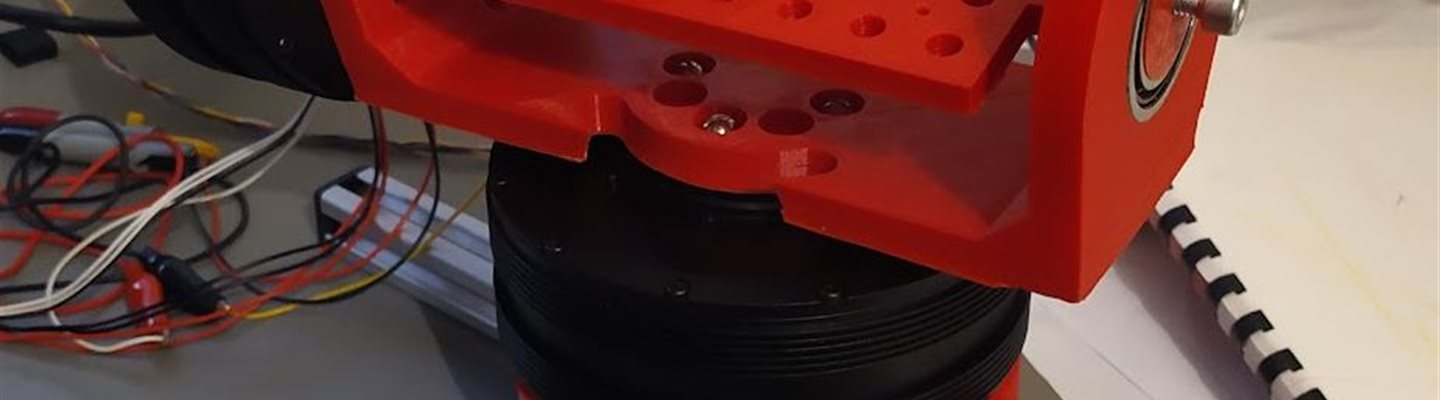

Mechanics
Naturally, I needed some physical body/chassis to hold all the parts together. For this I designed the necessary parts in Solidworks.
I then printed the parts on a 3d printer and assembled them together.
image image
It took me ~3 days of design and print iterations to get to the current state.  While there are still improvements to be made, the design is workable and I am happy with it for now.
