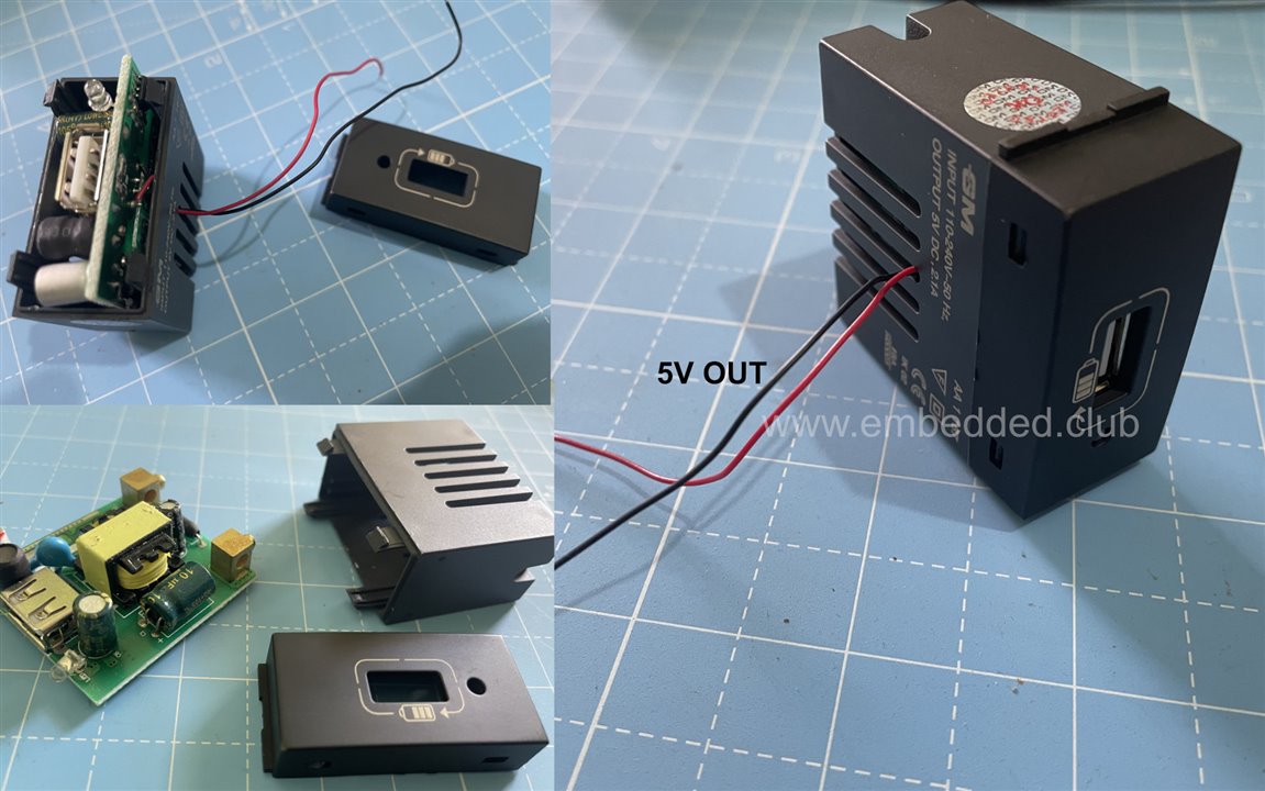

Setting Up 5V Power
The sensor , LED's & speaker to operate its required 3.3v and its sourced from the Pico. Pico board required 5V Supply.
So far I have been running the Pico board with USB Power , Now the circuit should operate on 230v Power.
It requires the USB charger module (from GM) , it gives 5V, 2A output which is more than enough to run the Raspberry Pi Pico and LED's.
The 5V power is taken out from the internal circuit of the USB charger like below. These 5V is connected to the Pico VBUS.
