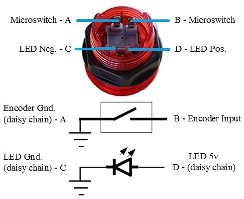

The pinout of this switch is as shown in the image below

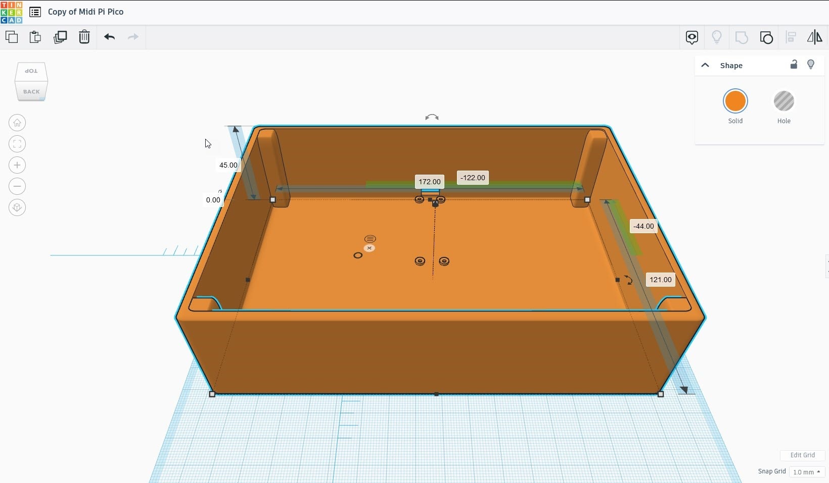

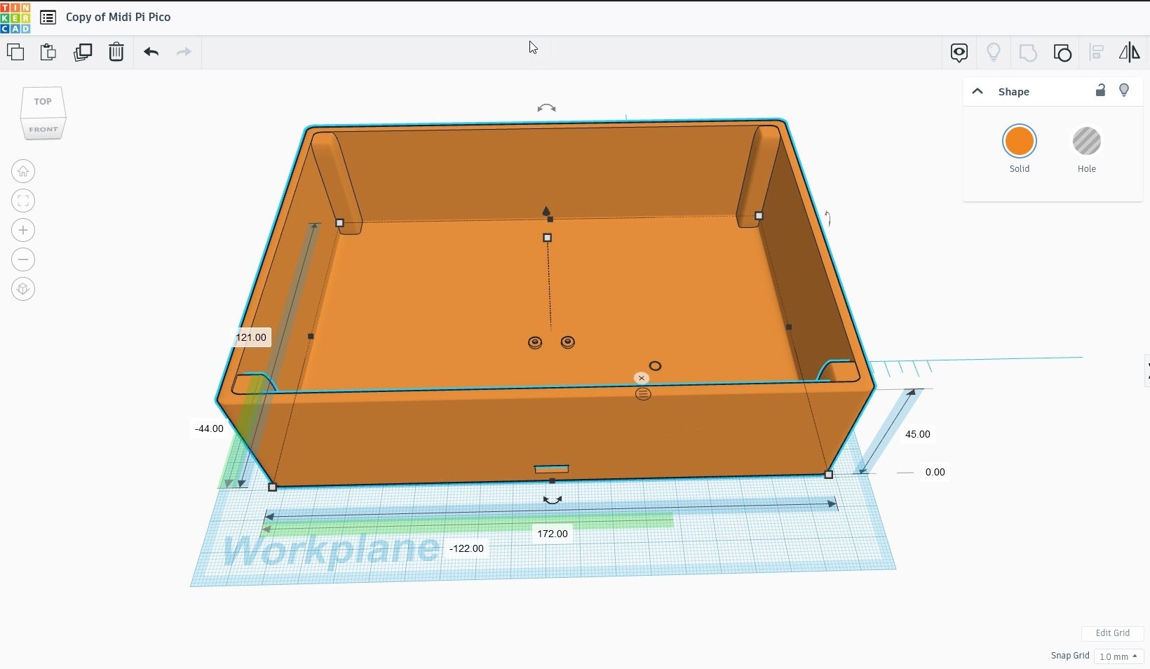

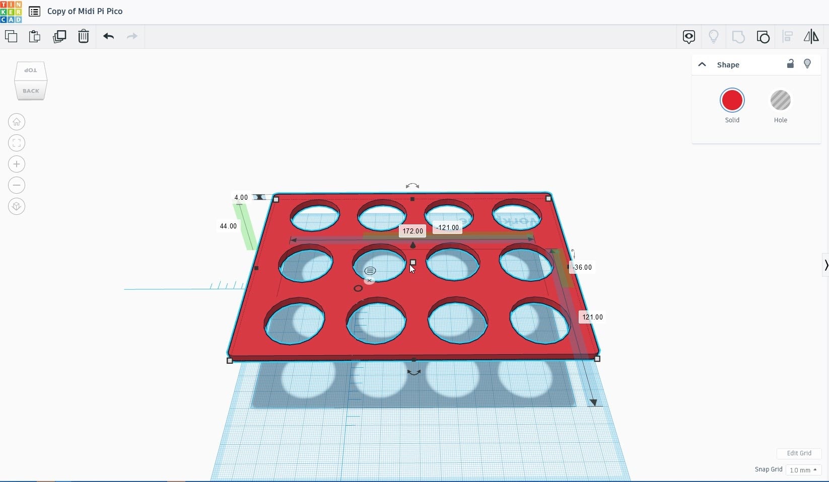

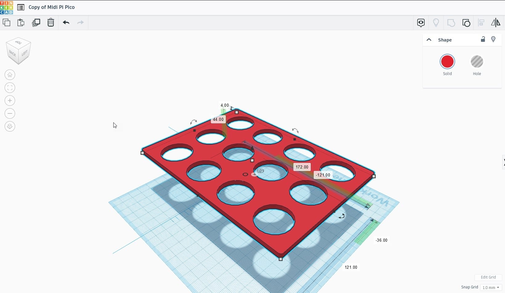

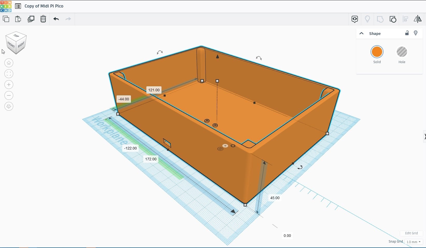

You may be thinking about how we want to get this done. Definitely, you are right. We can't just solder them barely like that. We need to design the enclosure as well as the place to fix the push button. For this, I have decided to design a simple enclosure to place the push button as well as to put all the wiring inside it. I used the Tinkercad to design the enclosure. Below is the design of the enclosure.
Once the designing part is done, I printed the model. In the next blog, we shall assemble the components and complete the hardware part.
