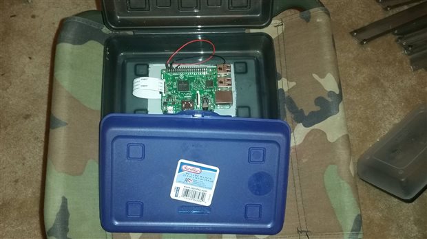

As such I looked into the larger of the 3 cases first, cutting out a hole large enough to slip the metal frame on to allow screws to be drilled through the case and securing it.  My original hole was in the top of the case.  I think mainly because a case is designed with the top up so that is what I tried.  :-)
Here I am showing the F.O.C. mounted to the large box.  Another box is shown above to give you an idea of depth for expansion.  While this wasn't bad there were 2 issues from my point of view.
First mounting to the top of the case, the lid, just wasn't the best option for being able to run cables through main box since you would have to carefully open the lid every time watching all of the cable routing.
Second, it just didn't feel comfortable in my hand.  That extra depth made if feel like a plastic brick.  If you don't plan on holding the F.O.C. Box and just want a containment system to set to the side and use perhaps with an external keyboard and mouse option, then the larger box is not a bad way to go.  Especially for only 25 cents.

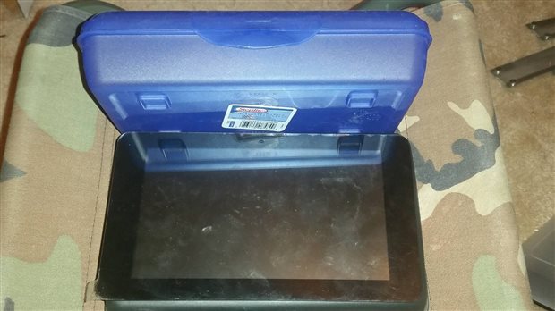

Here is the mid-sized option.  Just a tad smaller in the depth.  It looks even smaller then it is because this time I flipped the box over and used the bottom to mount the screen.  This fits my hand much better and I can imagine using the touchscreen and the potential of a battery setup very easily with this in place.
It is hard to tell in this picture, tomorrow I will try to get a new picture with the screws in place and everything wired in, but for now if you look at the 4 plastic squares on the box, they actually line up perfectly with the metal mounting spots on the RPi Screen.  As you can see from the bottom box that I have not cut into, the little boxes are recessed and the extruded part of the metal frame fits right into those.  Making for a great fit once you take some washers and screws and fit it together!
10 cents is not a bad price either, in fact I spent more on the screws and washers then the boxes.
