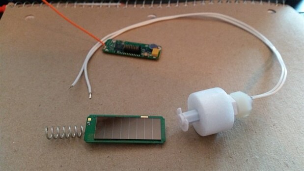

I had ordered a float sensor and was looking forward to seeing if I could tie into the Temperature card since data on it showed inputs that might be of use.  Of course having current Temperature around animals is always a plus.

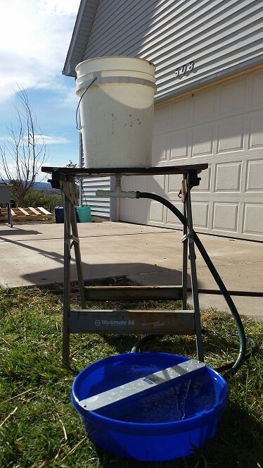

The Float sensor is to be installed into this Watering system.  The bottom bowl has a float controlled water input.  The 5 gallon bucket would be where the float sensor would reside to alert when the water was low.  As you can see below the bucket, I have planned ahead by putting a T.  The capped part of the T will be routed over to my Rabbit Cages to allow each rabbit to have it's own individual water source via the Chicken Nipples I have previously shown.  The blue bowl will be for my G.O.A.Ts.  Depending on how quickly the water is went through I may tie in another 5 gallon bucket as well.  But that requires future monitoring.

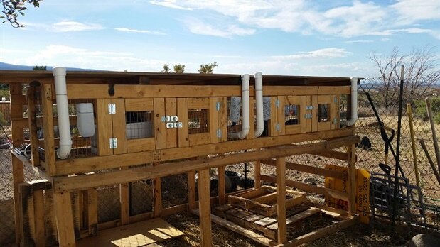

Here is the one complete Rabbit cage.  You can see the individual pvc feeder tubes I have in place.  I want to do similar for the water but have them all tied into the bucket system shown above.  On the left hand side you can see the Baby Box with Momma Rabbit perched on top of the box.
