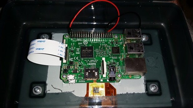

As I had mentioned before the medium sized box worked perfectly as a container for the 7 inch touchscreen with Pi3 attached.
As you can see here, the 4 squares line up perfectly with the metal frame of the touchscreen.  Making for an easy mounting of the F.O.C. to the plastic container.

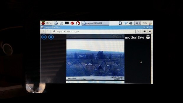

Here we have the view of Camera 2 moved over to monitor the Duck Domain.  With an easy swipe of a finger up or down I can look at any of the camera feeds!
