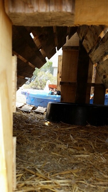

So the problem addressed to me, using the handy dandy egg roller tool (see above) to get eggs out of the Ducky Domain Domicile is less than efficient.  I have been planning out a sliding door option for the Chicken Casa and thought this would be a good opportunity to apply it quickly using some materials on hand.
I have been trying to use free materials as much as possible, recycling and no cost are big pluses on this Farm.
So taking a handy dandy pallet, I left one solid board on the bottom to ensure nesting materials stay in the nest and then removed 2 boards out of the middle section on both front and back, ending up with 4 cut boards. #1
I then took 2 2x4s a little smaller then 1/2 the height of the pallet and screwed the 4 boards on to them at the appropriate location to allow for the 2x4 door to be fully down and have the hole covered as shown above.  #2
I then used some baling wire attached to the top of the sliding door to allow a firm handle to lift up and control the door.  #3
Finally I added a hole through the pallet and the door that when the door is lifted a screw can be put in to hold everything up and in place.  There is a staple on the top to hold the screw when it is not being used.  #4
Here is the "back" side, which will actually be the inside.  You can better see how the 2 2x4s were put in place with the 4 cut boards sealing the hole.
You can also see a little better view of the wire handle for lifting the door.
Here is the door locked into it's up position.  Next step, install it and have the wife test it out.
Here the pallet back with sliding door has been placed onto the backside of the Duck Domain Domicile to allow easy access for eggs.
The view through the new sliding door!  The wife loves it and now wants 3 more.  Sigh...
