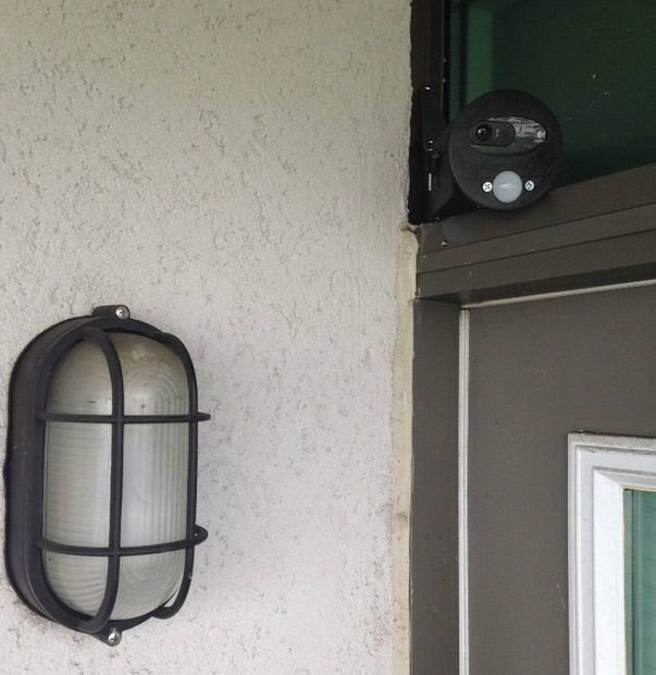

  • DIY Security camera (Currently Work in Progress using an A+ that I have handy)
Like any other security camera this the DIY security camera you will have basic feature, like Pi camera feed will show up on the Control Hub. You will have two buttons(as part of the web app) below the feed to take a picture and take a 1 min video .
This will use Pi B+ with one of the Pi Cameras which will come as part of the kit

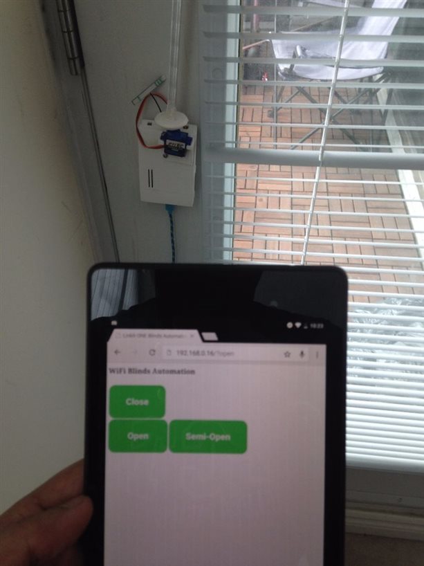

  • Blinds Automation
The hardware for this Pi Zero (borrowed from a friend, who has agreed to give me his ,till I find him a replacement with the added bonus of the  new pi Zero with Camera connector image )+ Wifi adapter + Continuous rotation servo or  gear motor (i will need a motor driver if i am using a gear motor )+Photo cell and capacitor for detecting light(currently have all these components) + 3D printed case
This will need open and close button on the Control Hub screen

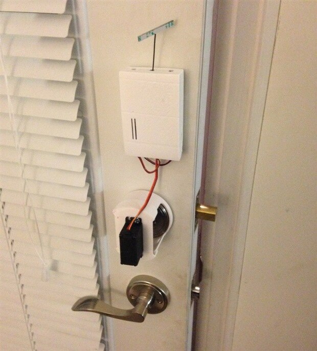

  • Keyless door entry
The hardware for this Pi B+ (used in the Security Camera - I will have to figure out the wiring to the door lock image) + Servo + 3D printed parts
As part of this feature you will be able to unlock the door if your smart phone is connected to the home wifi router and you know the secret password. Here I have the 3D printed part and the servo parts ready from a previous project , will have to figure out how/if I can use the Pi B+ from the security camera

    carmelito over 10 years ago in reply to pettitda +1
    Yes, it did work when I did something similar with an Arduino board as shown in the picture above.I will post a blog with the STL files and the code in a couple of weeks.. Here is the link to the servo…
  • carmelito
    Yes, it did work when I did something similar with an Arduino board as shown in the picture above.I will post a blog with the STL files and the code in a couple of weeks.. Here is the link to the servo I used in the picture above- https://www.creatroninc.com/product/standard-servo-motor-44kgcm/?search_query=servo&results=45
  • pettitda
    pettitda over 10 years ago
    Does the door lock actually work?  It seems like a servo wouldn't have enough torque to open the deadbolt.
