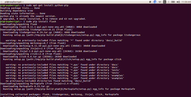

#1 Installing Flask on the Pi
      once you have ssh'ed into you Pi use the following commands
         sudo apt-get update
         sudo apt-get upgrade
     install pip , a python package management system using
         sudo apt-get install python-pip
      install flask , which we are going to use to build a simple web app
           sudo pip install flask

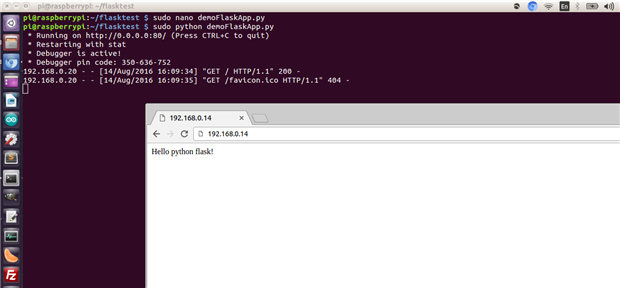

#2 Test the flask install
     Setup a simple flask web app to check if the installation was successful, open the nano editor and copy paste the code below
          sudo nano demoFlaskApp.py
     And then to run the web app
          sudo python demoFlaskApp.py
from flask import Flask
app = Flask(__name__)
@app.route('/')
def doorlock():
    return 'Hello python flask!'
if __name__ == '__main__':
    app.run(host='0.0.0.0', port=80, debug=True)
     To open the app in your browser type: http://ipaddressOfPi:80

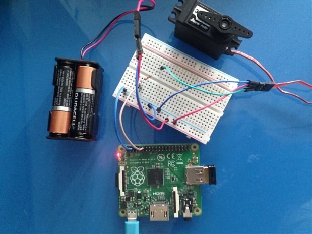

#3 Connect the Servo to the Raspberry Pi A+
      As part of the circuit
  •        Connect the servo to GPIO pin number 18 on the Pi, which is a PWM pin
  •        To power up the servo I am using 4 AA batteries (this is a temporary setup, but in the final setup we are going to cut a USB cable to power up the servo)
  •        Connect the GND pin of the Pi to GND pin of battery pack and the servo.
  •         I am also using a 1K ohms resistor to protect the GPIO pin from unexpected high current .
     Note : In my case, I am using  a Raspberry Pi A+ , but you can use any version of the Pi for this setup.

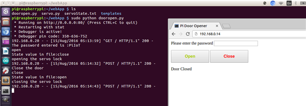

#5 Once you have your servo's moving download  zip which contains the flask web app and FTP it to your Pi
   In the webApp folder run the following command to run the web-app
     sudo python dooropen.py
Note: if you are using the same code in the zip file, the password is PiIoT image to open the door  ..
