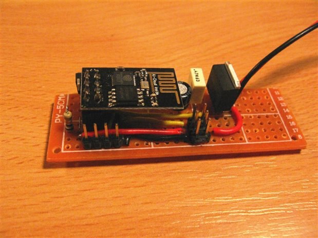

     On the hardware side, I needed more ESP nodes in order to collect environment values from multiple points around the house. For these new nodes I decided to use ESP-01 modules, they are smaller and I hope I'll be able to embed them more easily in common things around the house. They have only two GPIOs available but I think it will be enough for now.
One thing I noticed, the DS18B20 temperature sensor don't like to be nearby live electronics, especially in the vicinity of the RF part of ESP modules. Temperature readings were at least 5 deg. Celsius higher that in reality. So I moved sensor from onboard socket on a 10cm twisted wire and adverse effects disappeared.
