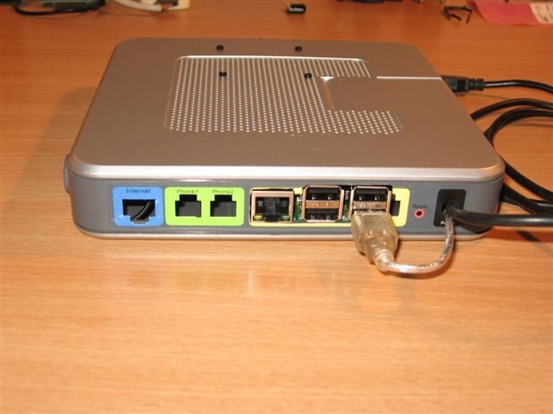

     Now is time to take all pieces and put everything in a nice box. As with most of my projects, it was a real struggle to find an enclosure to fit all components I have so far and at the same time to be suitable to be put in plain sight. So after spending more than a week on this subject, I found an enclosure from a broken wireless router which looks like the right choice, still not perfect, but will do for now:
Situation is about the same on the sensors side where the hunt for enclosures is still on. So far only one of them have an enclosure made from a kitchen timer...
Oddly enough, "antenna" is actually the temperature sensor which have to be as far as possible from ESP module to be able to show real temperature values. So far I did not found a way to shield the sensor from radio interference caused by ESP module and keep it inside the enclosure.

    Nice solution. I also appreciated the use of the box of a Linksys router to host the parts... Enrico
