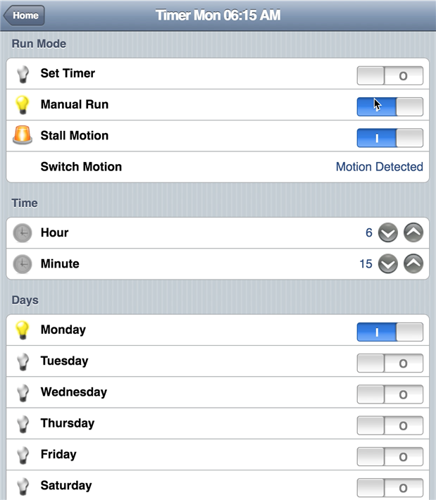

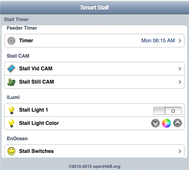

The Initial interface for the OpenHAB config displays the Feeder Timer, an option to set the Timer, Stall CAM (Both Video and Still cam options), The iLumi BLE Lights and EnOcean Energy Harvesting Switches.
From the Stall Timer, the user can Set the Timer by setting the Set_Timer switch to on.  The will grab the Timer that is site from the OpenHAB interface and send it to the feeder/timer topic which is picked up by the Feeder system. Also, the user can run the Feeder manually from the interface.  And, if there is motion, the Stall Motion indicator will be lit.
From the interface, the user selects the Time (Hour/Min) and the day to run the timer and once selected, click the Set Timer Switch.
Sitemap
sitemap home label="Smart Stall"
        Frame label="Stall Timer" {
                Frame label="Feeder Timer" {
                        Text label="Timer [%s]" item=timerMessage icon="clock" {
                                Frame label="Run Mode"  {
                                        Switch item=Set_Timer label="Set Timer"
                                        Switch item=Manual_Run label="Manual Run"
                                        Switch item=Motion_Alert label="Stall Motion"
                                        Text item=Motion_Detect
                                Frame label="Time"  {
                                        Setpoint item=Set_Hour minValue=0 maxValue=23 step=1
                                        Setpoint item=Set_Minute minValue=0 maxValue=55 step=5
                                Frame label="Days" {
                                        Switch item=timerMonday
                                        Switch item=timerTuesday
                                        Switch item=timerWednesday
                                        Switch item=timerThursday
                                        Switch item=timerFriday
                                        Switch item=timerSaturday
                                        Switch item=timerSunday

With all of that, this is what it looks like in the raw, nothing in case at this point.
