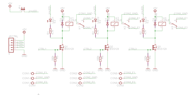

Relay Switches
To leave the possibility to control the lights in the old way I used a staircase switch connected to the relays board. The relays are RM50-3011-85-1005 which actually works as a staircase switch by changing the connection from the main pin to one of the two out pins. Here are some explanation of how to connect the switches: StairCase Wiring Circuit Diagram. Electrical Technolg
The relay board is supposed to be controlled by an Atmel Chip which cannot provide the power for the relays to function so I used a simple transistor system to digitally control them.
The schema is for three switches.

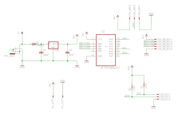

Lights controller
The lights controllers use a AT Tiny micro controller to ensure the connection to the main system through I2C and control the switches.
The component also has a voltage regulator because the ATTiny chip works on 5 volts and I sent 20 Volts through the cable to ensure that it provides a necessary 5 volts to all the components and also if needed it can have more power for motors for example.
The controller has two in pins for the I2C communication, three pins for the light switches and an IN pin for the ammeter.
The code for the controller is attached to the post.
Besides the actual control functions the component also have a ping and an identify function.
The ping is used for the main system to identify when a component has a notification and also that it has connection to the whole system. Because the I2C is a Master/Slave communication system and the ATTiny controller are not very fast, for notifications the main system pings all the known devices and checks if there are notifications to be communicated. The light controller does not have an alerting system nor does it need one but it seemed better the have the same interface working for all the components.
The Identification function is used by the main system to know how to control the component. The idea is to be able to connect one now controller to the system without actually "telling" the server on the Raspberry that you did so and how to control it. The identification is a simple string that has the I2C address, how many switches it controls and what type of a controller it is.

    DAB over 10 years ago +1
    Nice start. I will keep and eye on your posts, they look like they will be interesting to follow. DAB
