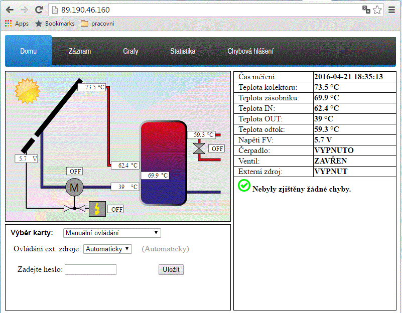

A touchscreen is connected to display graphics with measured values (and also voltage actually supplied by photo-voltaic panel is measured by a spare ADC channel for information purposes) and to eventually manually control on / off switching of the external power supply (to switch the heating fluid pump on and off). See the example picture of a web interface below (courtesy of Ladislav Lebeda).

    Final Solution and Results
    The above described controller design was subject of a diploma thesis [1] where the detailed description of both HW and SW used can be found. During several months of utilization the design proved it's usability: The energy intake achieved with deployment of external power source was quantified to be above 20% of the overall energy intake, see below. This can be even more when used in less optimal - not so much sun as during summer - conditions. What should be still solved is database management as actually all the data are kept forever which is not applicable for an embedded design solution.
    Statistics display of the overall solar energy intake (whole circle) with the contribution of external power source showed in grey (courtesy of Ladislav Lebeda).
