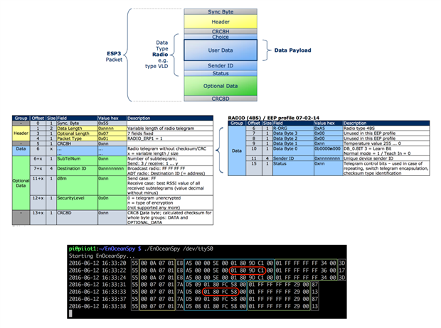

2016-06-12 09:46:54  55 00 0A 07 01 EB A5 00 00 63 00 01 80 9D C1 00 01 FF FF FF FF 31 00 B7
2016-06-12 09:46:59  55 00 0A 07 01 EB A5 00 00 62 00 01 80 9D C1 00 01 FF FF FF FF 2D 00 F9
2016-06-12 09:47:01  55 00 0A 07 01 EB A5 00 00 62 00 01 80 9D C1 00 01 FF FF FF FF 2D 00 F9
This data can now be parsed to determine the sensor ID required by the EnOcean binding in OpenHAB.
Interpreting
Unless you are planning to write your own application to parse the EnOcean telegrams, the most useful/relevant part is the sensor ID, which can be used by another application such as OpenHAB.
The structure and content of such a telegram is described in detail in the EnOcean documentation:
  • Enocean: Specification for EnOcean Serial Protocol 3 (ESP3)
Below is an illustration of the relevant data of the documentation, and how it maps to the data received via EnOceanPi.
Based on this, I was able to retrieve all sensor IDs and configure them in OpenHAB, to be used with the EnOcean binding.

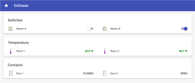

The result should look something like this, although the GUI itself may differ, as I'm experimenting with PaperUI.
Using the sensors results in realtime updates:
Now you know how to set up EnOceanPi and sensors!
