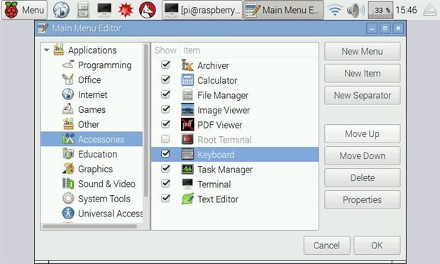

I was hoping to put together the central unit using only the components included in the kit. I might have been able to do it except for the fact that Raspian doesn't have an onscreen keyboard, so although I was able to get the machine up and running without any external parts, I still had to connect a keyboard to install the on screen matchbox-keyboard.
# Install the virtual keyboard
sudo apt-get install matchbox-keyboard
# After installing the keyboard, reboot.
# It should appear on the desktop in Menu->Accessories->Keyboard
After installing matchbox-keyboard, I still did not have a menu option for it. If that is the case for you, simply go into Menu->Preferences->Main Menu Editor->Applications->Accessories. Enable the keyboard by clicking its' "Show" option.
