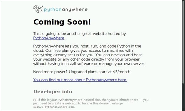

Regardless of whether you have the screensaver enabled, we need to launch the web browser and place it in full screen mode. Add the final line to the end of the file.
@/home/pi/fullscreen.sh
When you reboot, your screen should appear something like:
That wraps up this installment. I hope you are able to use the information presented to setup your own dedicated Raspberry Pi Information Kiosk.
