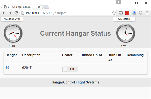

There are many different individuals that will need access to the HangarControl system. Pilots may be at home, at their office, or on the road. With that in mind, I wanted to create a single web interface that would accommodate a variety of browsers, including desktop, tablets, and smartphones. To ease the pain of coding HTML for all of the different platforms, I chose to use jQuery Mobile (http://demos.jquerymobile.com/1.1.2/) for the front-end toolset. Don't let anyone fool you -- There is still quite a learning curve when using "the easiest way to build sites and apps that are accessible on all popular smartphone, tablet and desktop devices!" That quote is from the jQuery mobile website. I referred to it often, the quote that is, when I needed to convince myself that front-end coding could be even more difficult. Enough of that, let's move on to the structure.

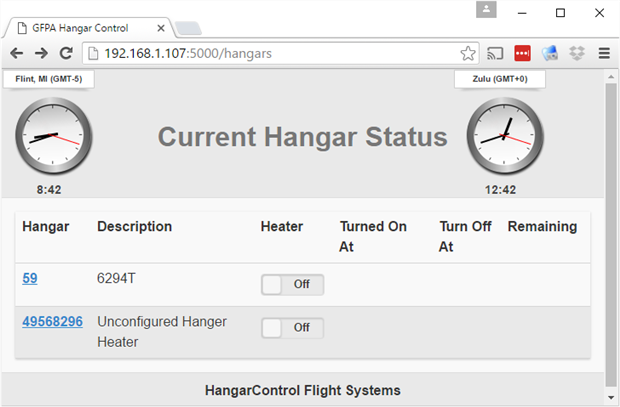

New Node Turns On
Each node (Raspberry Pi + Heater Relay) is flashed with the same image. A node broadcasts it presence and then waits for messages. The web interface of HangarControl provides an Administrator a link to configure each node. Note the "Unconfigured Hangar" below.
Configure a Hangar
Clicking on the "49568296" link brings us to a page where the Administrator can name the hangar and airplane. Here is where we can specify how long the heater runs as well as the Raspberry Pi GPIO pin for controlling the heater relay.

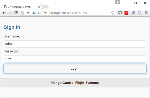

Logging in and User Authenticationimage
Flask provides a number of optional modules that you may use to supplement your project. One of these is Flask-Login, which I am using to aid in session management. Take a look at Episode #8 ([Pi IoT] HangarControl #8.1 -- What's a database? The Movie or [Pi IoT] HangarControl #8, Database? What's a Database?) for a behind the scenes look at integrating with Flask-Login.
Since authentication is such an important component of any public facing application, I will show you what you need to write if you plan on using Flask-Login yourself.

Present the login page until successfully validated
# The URL for logging in. A user gets directed here automatically
# when they select their first page which has been tagged with @login_required
@app.route('/login', methods=['GET', 'POST'])
def login():
    error = None
    next = request.args.get('next')
    if request.method == 'POST':
        user = User.find_by_username(request.form['username'])
        log.info("login: user=%s", user)
        if user == None:
            error = 'Invalid username'
        elif request.form['password'] != getattr(user,'password'):
            error = 'Invalid password got=%s, expected=%s' % (request.form['password'], getattr(user,'password'))
        else:
            login_user(user,remember=True)
            flash('You were logged in')
            # next_is_valid should check if the user has valid
            # permission to access the `next` url
            if not next_is_valid(next):
                return abort(400)
            return redirect(next or url_for('hangars'))
        return render_template('login.html', form=form)
    return render_template('login.html', error=error)

Online and Available
At this point we have a completely function system and pilots are able to request (automated) preheating service.
  1. A Raspberry Pi 3 is the primary workhorse. It acts as our xPL communication hub handling messages between hangars and administrative applications.
  2. This same RPi3 is running the Flask application server and provides our HangarControl web interface. Use of smartphones, tablets, and desktop devices has been made seamless with jQuery mobile front end library.
  3. The RPi3 also services the heater in a single hangar.
  4. Additional hangars can be included by adding another networked RPi. When HangarControl "hears" the new hangar it is added to the list of hangars and the Administrator simply clicks the configure link to specify duration and the GPIO pin.
