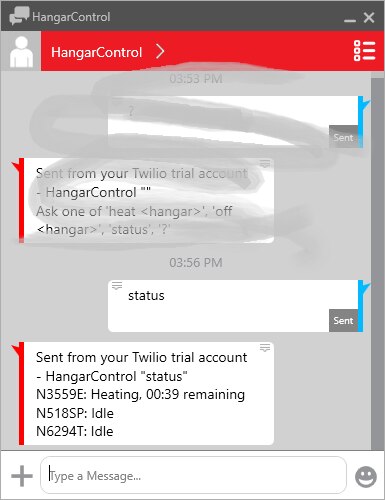

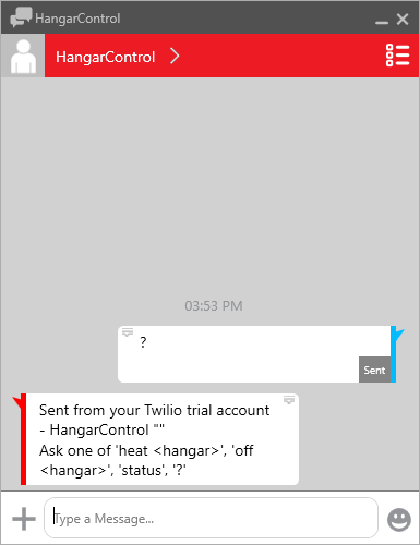

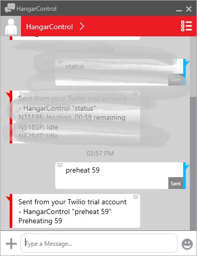

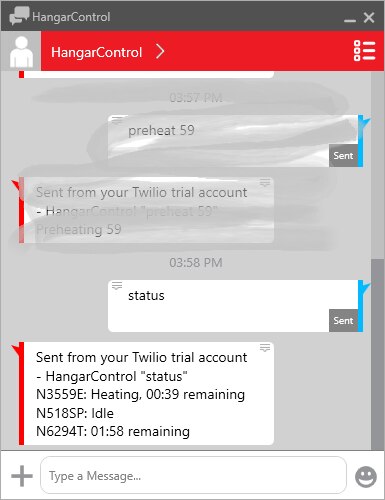

Using HangarControl with Text Messages
Getting Help
Status of Hangars
Preheat an Engine
Status While Preheating
SMS In a Nutshell
