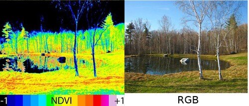

The Normalized Difference Vegetation Index (NDVI) is a numerical indicator that uses the visible and near-infrared bands of the electromagnetic spectrum, and is adopted to analyze remote sensing measurements and assess whether the target being observed contains live green vegetation or not. NDVI has found a wide application in vegetative studies as it has been used to estimate crop yields, pasture performance, and rangeland carrying capacities among others. It is often directly related to other ground parameters such as percent of ground cover, photosynthetic activity of the plant, surface water, leaf area index and the amount of biomass. NDVI was first used in 1973 by Rouse et al. from the Remote Sensing Centre of Texas A&M University. Generally, healthy vegetation will absorb most of the visible light that falls on it, and reflects a large portion of the near-infrared light. Unhealthy or sparse vegetation reflects more visible light and less near-infrared light. Bare soils on the other hand reflect moderately in both the red and infrared portion of the electromagnetic spectrum (Holme et al 1987).
Since we know the behavior of plants across the electromagnetic spectrum, we can derive NDVI information by focusing on the satellite bands that are most sensitive to vegetation information (near-infrared and red). The bigger the difference therefore between the near-infrared and the red reflectance, the more vegetation there has to be.
The NDVI algorithm subtracts the red reflectance values from the near-infrared and divides it by the sum of near-infrared and red bands.
NDVI= (NIR-RED) / (NIR+RED)
This formulation allows us to cope with the fact that two identical patches of vegetation could have different values if one were, for example in bright sunshine, and another under a cloudy sky. The bright pixels would all have larger values, and therefore a
larger absolute difference between the bands. This is avoided by dividing by the sum of the reflectances.
Theoretically, NDVI values are represented as a ratio ranging in value from -1 to 1 but in practice extreme negative values represent water, values around zero represent bare soil and values over 6 represent dense green vegetation.
(Also see: https://en.wikipedia.org/wiki/Normalized_Difference_Vegetation_Index )
Here is an example from (https://publiclab.org/wiki/near-infrared-camera )

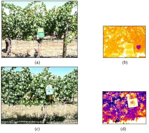

  2. Second approach is to use both cameras and use the NIR band from the Pi Noir and the red band from the Pi Camera. The images can be overlaid using image processing software like OpenCV (OpenCV | OpenCV ), using image registration functions (OpenCV: Image Registration ) and the NDVI can be calculated. Here is an example from (Automatic Optical and Infrared Image Registration for Plant Water Stress Sensing | InTechOpen)
Results of SIFT based registration algorithm (no matching key-points) (a) 5906 keypoints found in optical image, (b) 447 keypoints found in IR image, (c) 5666 keypoints found in optical image, (d) 605 keypoints found in IR image
