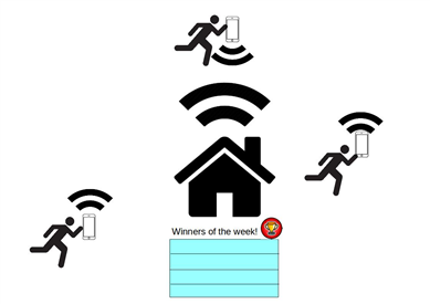

Smart-homes are one of the most popular applications in IoT. It is very convenient when you can access your house information (and never wonder again whether the door was left open or the kitchen stove is on), and even have some basic automatic features implemented (temperature auto-set, lights off when they are not needed etc).
We implemented a prototype with these temperature and pressure recording system a few weeks ago (just to test if could have a simple MQTT architecture), with only some basic monitoring features. We want to add persistence to the system (a storing database), an actual interface and some remote capabilities. Also, new interesting devices can be included in the platform: a gas detector or a camera to be accesses when out of the home.
But wait... there is more: for this IoT challenge, we are also proposing a fun version of this IoT smart-house, where current inhabitants are not only treated as part of the system, but will also compete to be the number one.
The original platform is exercise oriented. We will implement first the simplest case: a running kind of competition. Here, each person will use their phones to track the miles they have run during the week, so the person with a higher number will get more points and a higher position in the general ranking. We can add some extra information, to get some variety: use the accelerometer/gyroscope of the phone or some other wearable devices (a wristband or a heart rate monitor for example).

Competition game
With a smarthome implemented, we want to increase the reach of the platform. This way, our home users will not feel disconnected even when they leave the apartment. The proposed scenario is built as a runners competition kind of game: using the smart-phone information, our smart home will also define a ranking. They way any user can go up in this ranking is by running/walking more and more miles. As a result, the smart home capabilites will also be extended outside the house itself, to be able to follow our happy runners.
We will have a web server built on the Raspberry Pi(our home central node). Each smartphone device will have an application that:
  • Monitors the user's run distance
  • Sends that information to home, to the central node.
Furthermore, this central node will implement a simple routine to add the distance and display our inhabitants in decreasing order. This simple routine can further be extended (with some additional code in the phone to) to add some more challenging/original tasks: such as, assigning extra point to people going to certain areas (we will have to include geo location capabilities).

    clazarom over 10 years ago in reply to dougw
    True, thanks for pointing the difficulty out. I did not think of that, but a fairer competition should have different levels of difficulty, as you said. I will add some "level of difficulty" feature per participant.

  • clazarom
    clazarom over 10 years ago in reply to georgekav
    A very good point! Keeping the residents engaged and interested is not an easy task: if it is only a matter of running more miles than my roommate every week.... well, it can get boring very fast.
    At first I was thinking of only combining a Run app (like the ones people use to show how many miles they run, what was the route etc.) into the smart home environment. And to push a bit more the healthy life style, presenting a direct competition among roommates. To include some variety, I want to add the extra "go to this particular point" (where the point is an interesting location in Chicago) or some other small challenges.
    Though, at this point, the smart competition home is more a 'what if' kind of exercise.
