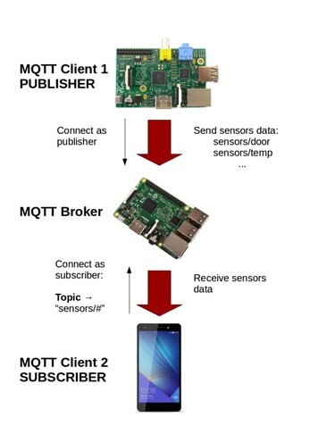

MQTT deploys a publish/subscribe architecture, with a broker in the middle. To provide a multicast to multicast communication, information sources and destination are categorized as publisher and subscriber clients respectively. These clients connect to a central broker, which will manage the income information and distribute it accordingly.
The protocol behavior is orchestrated by the broker. Publishers will connect to the broker and send their data packages. Each of this packages will have a topic (the publisher sets this topic label to identify the type of information), used by the broker to organize them in queues. Subscriber clients can then subscribe to the topics of their interest. New packages arriving to the queue are received by the subscribed clients.

This MQTT architecture has three main elements. Their relationship is shown in the figure bellow:
Raspberry Pi 1 - Publisher
  • Sensor Node
  • Generates data (sensors reading)
  • Sends data to broker
Raspberry Pi 3 - Broker
  • Central node
  • Receives messages publishers
  • Organizes messages in topic queues
Samartphone - Subscriber
  • User's devices
  • Connected to broker
  • Displays sensors reading
          Figure 1. MQTT architecture

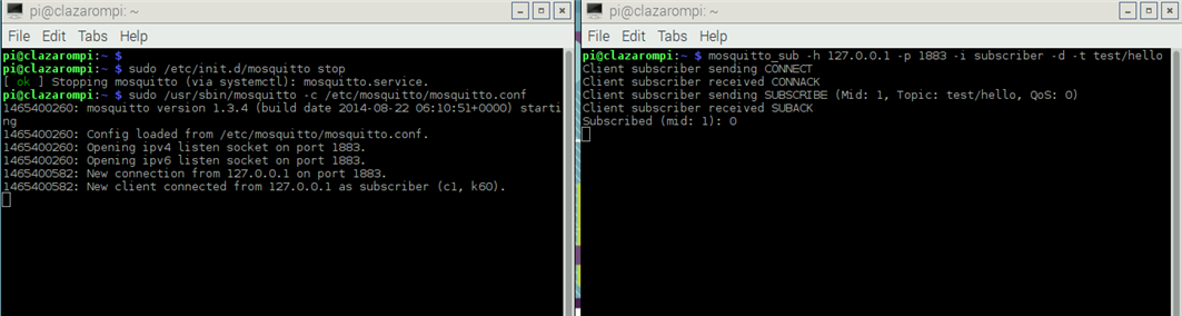

Test
Since mosquitto-clients wre also installed, I will use them to test our Mosquitto setup. I open three different terminals, to start the broker and create a subscriber client and a publisher client

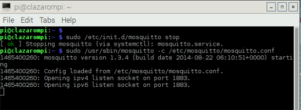

1. Start the broker in terminal 1
2. Create an mqtt subscriber client. It will be listening for message with topic 'test/hello' in terminal 2

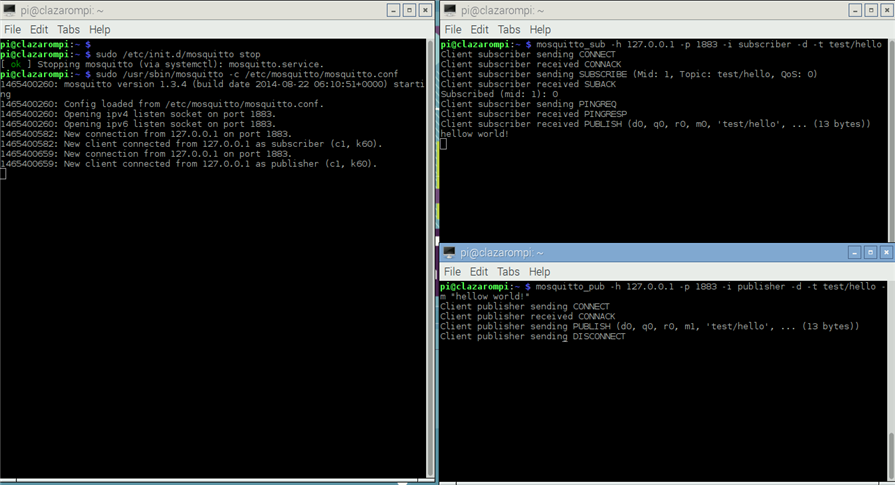

3. Create an mqtt publisher client. It will send a simple message "hello world!" (original, yeah!) with topic 'test/hello' in terminal 3
Figure 2. Start MQTT broker with our config file
Figure 3. Create a subscribe client. It is subscribed to the topic test/hello
Figure 4. Create a publisher client. Send the message "Hello world!"
(*) Mosquitto broker is automatically started. We stop it first, to then start a broker with the desired configuration
We got the message in our subscriber, hurray!!
