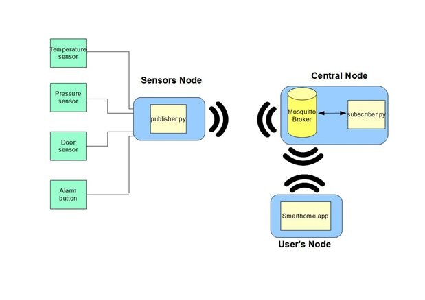

In this entry, I will be focusing in the “Sensors Node” of the smart house. As some may suspect, I will be explaining how the house generates data (from a set of sensors: temperature, pressure, door open/close), which can be distributed to various clients. In this architecture, sensors are wired to the node (Raspberry Pi 1), which is in charge of:
  1. Fetching data from each sensor (a complete list of sensors is presented in next sections)
  2. Publish this data to the “Central Node” (Raspberry Pi 3). To do so, the Sensors Node implements an MQTT client to be publishing this content to the MQTT broker(*) in the Central Node.
(*)Previous post described installation and setting up of MQTT broker, Mosquitto, in a Raspberry Pi 3.
Furthermore, a subscriber MQTT client is built in the Central Node, to display the read data in a terminal interface. The other MQTT client will be developed in a smartphone, so the user can access the information directly from their handheld device.
All MQTT clients are implemented using Paho, which provides libraries in Python (used in Sensors Node and Central Node scripts) and Java (used in the smartphone application)
Wireless communication among nodes is achieved using the same home WiFi network.

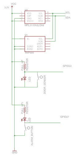

Hardware connections
The following figures represents the schematics of the Raspberry Pi 1 node. It features its 4 sensors and the corresponding Raspi 1 GPIO port they are connecting to.

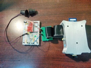

And the real sensors node….
This has been connected just to test the node: we still need to locate all the components in their right place: specially the door switch!!

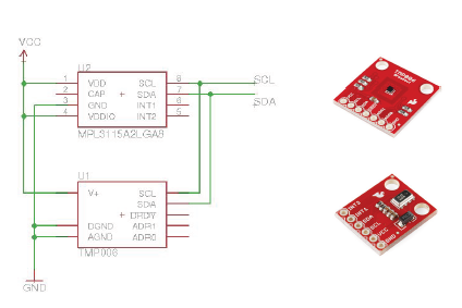

Temperature and Pressure sensors
Our temperature and pressure sensors are both connected to the I2C ports of Raspberry Pi 1, SCL and SDA.
The I2C protocol only needs two buses to connect several sensors together. Each individual component is identified by a unique byte-size address. In our case:
  • Temperature sensor - Ox40
  • Pressure sensor - Ox60
We want to emphasize that, even if we are using these default addresses, both chips are designed with two extra inputs which can define new addresses. Thus, we can have more than one of each of these sensors in the platform (for example, distributed among the rooms).

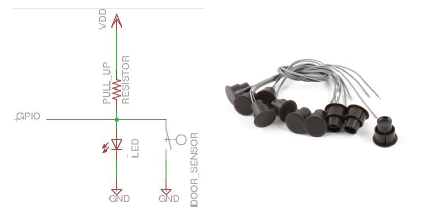

Door Switch & Alarm button
Alarm and door switches each will use a dedicated GPIO port. They both behave as switches, although they present opposite type of behavior.
DOOR SWITCH:
This switch works following a usually closed behavior. When the sensor is embedded in a magnetic field, it will stay closed. When there is not such a field, it behaves as a short circuit.
This door switch is usually sell with two parts: a magnet and the sensor to be wired in the control system. Each part will be located at different parts of the door itself. The magnet will be placed in one side of the door, whereas the sensors is at the doorjamb. This way, when the door is closed both parts are facing each other (magnetic field affecting the sensor), though when it opens they separate (with no magnetic field around, the sensor will open the circuit, providing a 1 for the digital input).
We include a LED in the circuit, to have a visual confirmation when the door is open.

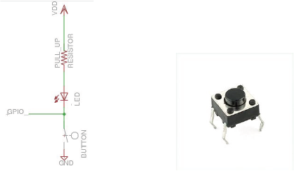

ALARM BUTTON:
This switch works following a usually open behavior. It will be open by default, and when the button is pressed the circuit will be closed. For this reason, the schematic implemented has the button between the GPIO port and ground. The digital input will be showing a 1 at its entrance until the button is closed (it
will connect to ground and change to 0).
Again, visual confirmation is included with a LED.

    mcb1 over 10 years ago in reply to mg.sergio +2
    mg.sergio You are quite right that the LED will drag the pin down. Most LED's are around 1.2-14v with the high brightness versions tending toward the 2-2.5v. clazarom I suspect it will require some additional…

  • clazarom
    clazarom over 10 years ago in reply to mcb1
    mg.sergio
    You are right about the LED voltage (the 0.7V) to work as the "1" value in the GPIO port when the door opens (thanks for bringing it up image). I was able to 'get away' with this configuration so far. Though, I tried some configurations before that were giving me either an "always open door" or "always closed door". I am not sure what kind of dark magic is allowing this simple LED to give me a "1" when the door opens, but it is destined to fail (or, at least, to skip some open door events).

    Thanks for the suggestions! I am going to add a diode in series with the LED. It seems to be the simpler solution... and I have some diodes at home ^^.
    mg.sergio
    clazarom
    I suspect it will require some additional hardware.
    One thought is adding a diode in series with the LED may be enough, otherwise a transistor with base resistor which will be turned ON when the door switch opens.
    This can then drive the LED and a suitable series resistor form whatever supply you want.
