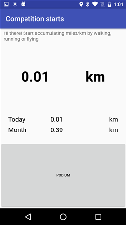

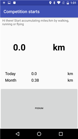

Competition System Activity - Version 1 (ONLY INDIVIDUAL TRACKING)
The GUI is constantly updated to show:
  1. Current distance
  2. Today's distance
  3. Monthly distance
Additionally, this information is stored in a local database in the phone.

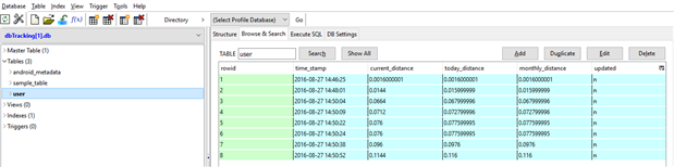

How to retain the information
http://a2.mzstatic.com/us/r30/Purple/v4/8f/8f/fe/8f8ffeba-a1bf-5c07-c714-8cc6a2852375/icon175x175.png
Local database - SQLite
SQLite library
Permissions
We include the WRITE and READ EXTERAL STORAGE permission in our Android Manifest:
<!-- Write and read -->
<uses-permission android:name="android.permission.READ_EXTERNAL_STORAGE" />
<uses-permission android:name="android.permission.WRITE_EXTERNAL_STORAGE" />
NOTE - For API 23 or more: permission request needs to be done during run time. So, I include the following lines in our CompetitionActivity (inside the onCreate() method)
** This code is shown in the previous section
The code: DatabaseManager.java
First, I developed the functions to constantly store the distance values in a table. This table has the user as name, and columns for the time_stamp, current distance, day distance,month distance and updated(to be used when updating to the central node server).
Thanks to this database the app will retrieve today's and the month accumulated distance when restarting !!

Please see the following video showing the first running of the application image
