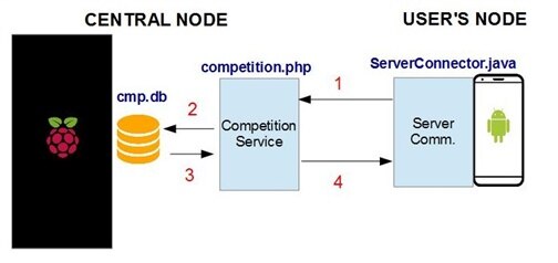

https://avatars2.githubusercontent.com/u/1294177?v=3&s=400To finish the Android competition application, I need to add the "updating functions". That is, send the information not updated to the Central Node (web server)  and wait for a confirmation. If the confirmation arrives, information is in the Raspberry Pi3 whereas, when not confirmation is received, data should be resent in the next cycle.image
This will require:
  1. HTTP_Client in the phone, to send the data as a HTTP_POST
  2. Communication service in the central node - PHP files able to receive the HTTP_POST message, extract the information and insert it into the database
Client and Server structure
We are focusing on the smart phone to central node communication. Data flow will start from the phone (client) to the central node (server).
1)User's node sends a HTTP_POST containing:
  1. Id - to be checked when received (to have some verification that the package was intended for the competition service)
  2. Distance tracked information for the user
The server check the id, and if it is the right one, it will extract the distance tracked information.
2)This information is saved into the database (created in post #5) to be access later on by the main GUI
3) If writing is successful, send response back to phone 4)

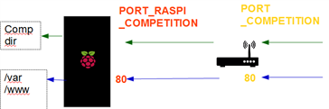

A bit more of Re routing
In post #5 I showed how to do a port forwarding from the WiFi router to the Central node. I used port 80, to have web traffic redirected to the web server in the Raspberry Pi 3 (also, using port 80). However, for the competition service, I will be using another port. It can be done in two steps:
  1. Adding a new Port Forwarding rule in the router. Traffic entering thru PORT_COMPETITION will be redirected to the central node, PORT_RASPI_COMPETITION
  2. In the Raspberry Pi 3, traffic coming thru PORT_RASPI_COMPETITION has to be redirected to the PHP files providing the Competition Service. We do so by configuring the Apache server (we have it listening to Ports: 80, PORT_RASPI_COMPETITION):
    • Modify its configuration files, in /etc/apache2/ to create a new VirtualHost for the PORT_RASPI_COMPETITION. It should point to the folder with the PHP Interface files.
    • Restart apache2
