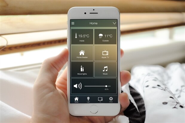

Mobile & On-The-Wall-UI
A home automation system can do quite some things automatic, but it can't read your mind yet. So there needs to be an interface to tell it what you want. For this an iPad will be installed in the living room for easy access to the most important actions and data, including controlling the home cinema. When walking around these actions are also available on the iPhones of me and my girlfriend. In the kitchen a Raspberry with the 7" touchscreen will give similar controls, this time giving data useful while for example preparing breakfast, such as the weather forecast and maybe even delayed trains.Two possibilities for further expansion are a dedicated iPhone as a home cinema remote and using an even more natural way of communication: speech. The latter will involve having a microphone connected to either a Raspberry or the wall-mounted iPad which always listens to a trigger phase (much like Apple's "Hey Siri") and afterwards can execute actions. This might however be a bridge too far for now.
Mockup of the iPhone app

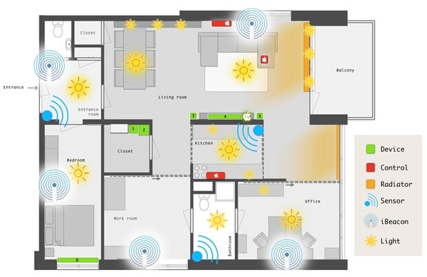

Results
The end product of this challenge will be an improved home automation system in my home. The core of the system will be a Raspberry Pi 3 with a WildFly server. The Java EE application running on this will manage the logic of the house and bridge the several parts together. On this same Raspberry the Razberry/Z-Way software will be installed to be able to communicate with Z-Wave devices. Another Raspberry will be used as part of the Home Cinema setup and will be hooked up through HDMI to the AV receiver. It will control a.o. the receiver and TV via CEC. Other apps in the system include the iOS apps for both iPhone and iPad, which act as remotes.An overview of the home with all the devices can be seen below:
Map of the home with devices. Numbers refer the hardware list below.
The most important aspect of the project will be the communication between the different nodes. The nodes communicate with each other using MQTT. This is a very light weight communication protocol providing a publisher/subscriber setup. It's very suitable for this project as it's able to send around information quickly and it's platform independent. To be developed and published as open source to my Github are at least:
  • MQTT integrations for a.o. Z-Way and Plex
  • A CEC Java library (with support for forwarding events to an MQTT topic)
  • MQTT based UI components for iOS
  • (optional) MQTT monitor which records events to a database for analysis
All these will help others who are working on a DIY home automation system, especially when they use MQTT for their communication.
Technology
Hardware
  • Raspberry Pi 3 with Razberry – Core server based on Java EE and Z-Way (1)
  • Raspberry Pi 1B – Connection with HDMI CEC (3)
  • Raspberry Pi 2B + 7" touch screen – Wall control in the kitchen
  • ReadyNAS – Plex Media Server (2)
  • iPhones – Serve as personal remote
  • iPad – On-The-Wall-UI
  • Z-Wave switches – Switching power sockets to turn devices on/off, most measure power usage as well
  • Z-Wave sensors – Multi sensors (motion, light, temperature)
  • Z-Wave radiator valves – Controlling the temperature
  • Estimote beacons – iBeacons to detect presence
  • Home Cinema setup – a.o. Sony TV, Denon Receiver, Apple TV (4, 5)
  • YouLess – Measures overall power usage
  • MOVE – Motorizes the curtains (6)
  • Optional: Arduino based sensors
  • Optional: Raspberry Pi/Arduino based Ambilight
