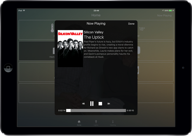

    func openNowPlaying() {
        DispatchQueue.main.async {
            self.performSegue(withIdentifier: "nowPlaying", sender: self)
The nowPlaying view itself is composed using some StackViews, UILabels and UIImageViews. The interesting thing about them is that these default iOS UI elements themselves are MQTT subscribers and update their content based on messages on the corresponding MQTT topic. This is possible because of two features of Swift: extensions and protocols. For example the UILabel can be made aware of MQTT as follows:
extension UILabel: MQTTSubscriber {
    func setMQTTTopic(_ topic: String) {
        MQTT.sharedInstance.subscribe(topic, subscriber: self);
    func didReceiveMessage(_ message: MQTTMessage) {
        if let payloadString = message.payloadString {
            DispatchQueue.main.async() {
                self.text = payloadString
Similar extensions are made for the other elements. The result looks like this:
Following these steps we set up the Home Theater flow to our iOS app and made sure everything works smoothly. In my opinion it still needs a bit of fine-tuning, but even now it works pretty well!
