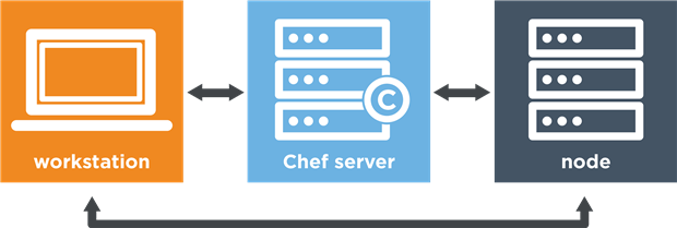

A typical setup consists of three elements: your workstation, a server, and nodes.
The server is the central repository for all code and it also keeps knowledge about every node it manages. From your workstation you write and verify the configuration policy and then upload it to the server. When you run chef-client on a node the latest code is downloaded from the server and the node's configuration is brought up-to-date.
