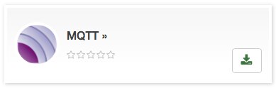

Z-Way allows developers to create userModules and publish them to their App Store. Unfortunately they still didn't reply to my submit, so it's available straight away. Luckily they do have a beta-token mechanism, so it's still possible to install it. I've used BaseModule by @maros as basis, so you'll need to install this as well. To install it follow these steps:image
  1. Go to the Management page of your Z-Way
  2. Open the App Store Access tab
  3. Add mqtt_beta as token
  4. Now go to Apps, and then Online Apps
  5. Search for Base Module and install it
  6. Search for MQTT and install it
