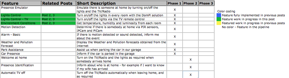

As suggested by DAB last time, I will add a snapshot with the features I´m discussing in each post. I hope this will make it easier to follow the project development!
This is a snapshot of all of the features from the PiIoT - DomPi: Intro. At the end of the post, you can find the nodes´ dashboard with some cells coming into green!

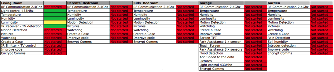

Nodes´ Dashboard
If anything needs further details or you have any suggestion, please do let me know!Write to you in the next post.image
