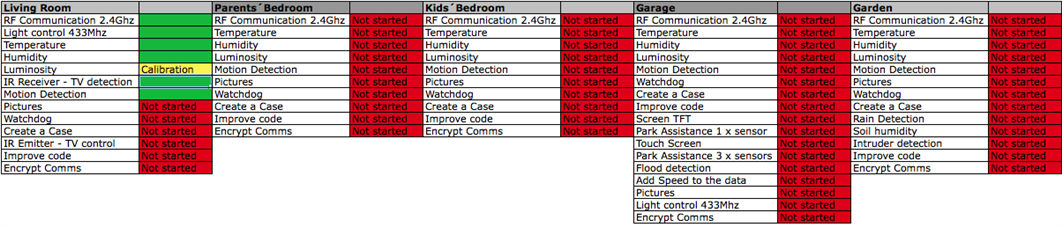

Nodes´ Dashboard
After this week, most of the basic components of the living room node are finished and several of them will be easily replicable in all the remote nodes, so hope to see more greens coming in shortly!
Any comments, suggestions or ideas are more than welcome!
