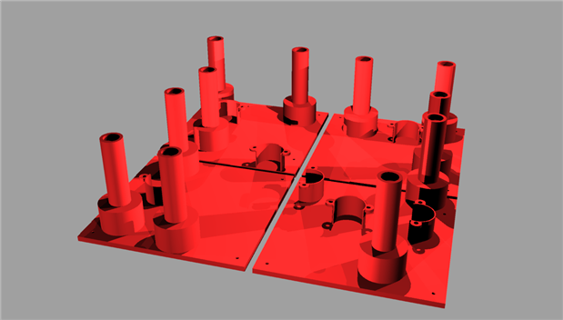

A reminder: the image below shows the rendered3D model

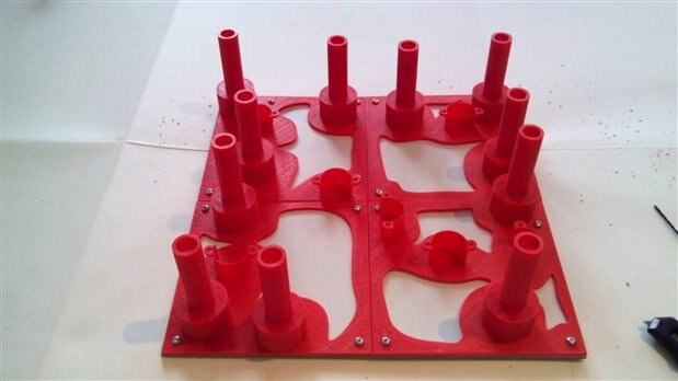

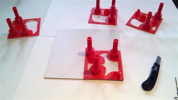

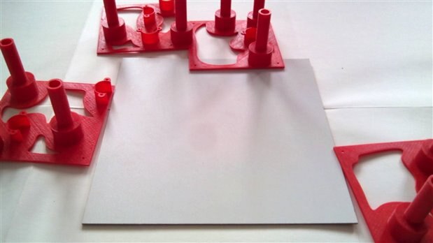

As the rest of the opera the finished Art-a-tronic is built of four main sectors. To keep together the four parts of the base a 5 mm compressed wood with white plastic laminate surface is used as bottom support. The image gallery below shows the construction phases.
{gallery} Base assembly steps
The laminate wooden support and the four sectors of the 3D printer base and motor holders.
The first piece fit in place. Every sector is fixed to the base with four screw. When the entire building is complete, the base will also be glued for better stability
The base assembly complete
Checking the parts positioning

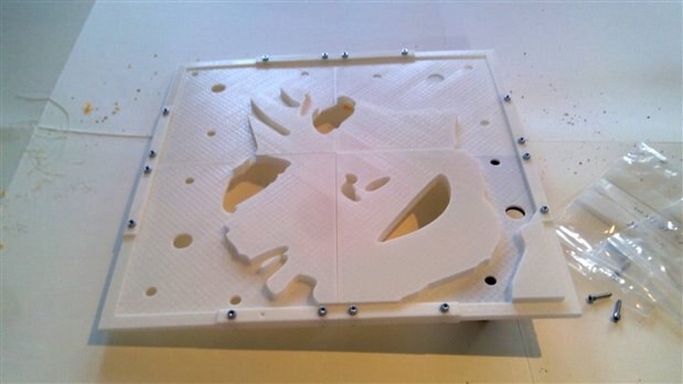

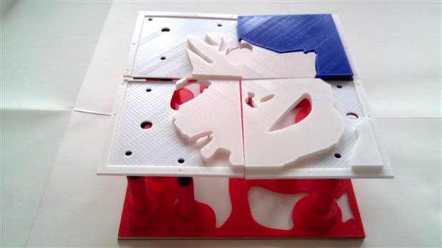

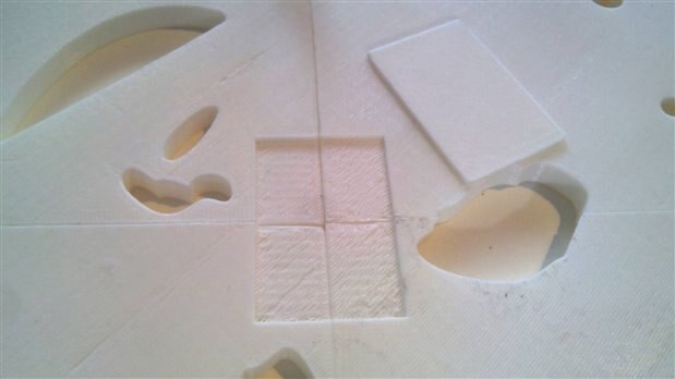

Preparing the top frame

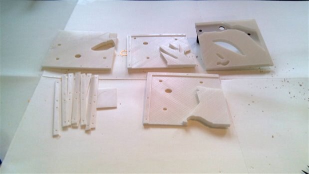

The most of the weight and mechanical stress should be supported by the base where the motors will be assembled further. The top frame is the visible white area of the opera and virtually has no stress but staying in place. For this reason this part has been printed with just a 25% of internal fill. To keep the four sectors flat and perfectly aligned - it is essential for the mechanic working properly - two different fixing methods bas been adopted: a screwed double support on the perimeter and a back dowel in the center.
The image gallery below shows the assembly phases of the top frame.
{gallery} Top frame assembly steps
The pieces of the top frame: the four secotrs, the perimetral supports and the dowel

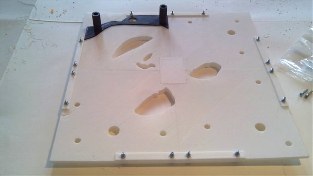

The frame perimeter double support screwed. This keep the four secors in their correct position
Top frame back: the centter inset for the dowel
Top frame back: the assembly is complete with the dowel glued in center.
