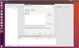

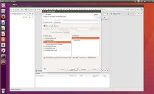

We should setup the Eclipse IDE to cross compile programs for the Raspberry PI.  We can use Eclipse in future also for other kind of development, not necessarily for the Raspberry PI platform we will create a new simple project and set the cross compiler options at a project level. The same settings will be applied to any future project we need to be cross compiled for the Raspberry PI

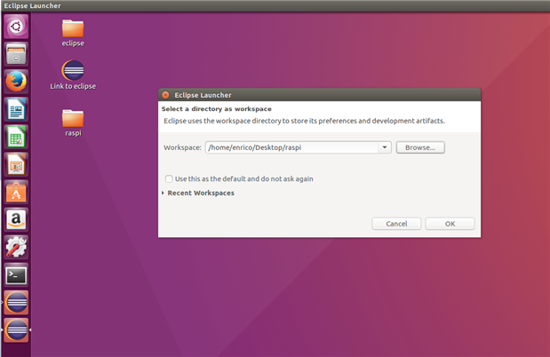

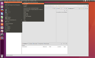

Launch the Eclipse IDE creating a new workspace. Here a ~/Desktop/raspi workspace folder has been created.

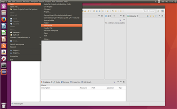

From the Eclipse main window create a new C++ project as shown in the images below
Here we have created a HelloRasPi project based on a GCC toolchain. After confirming the other stpes with Next button you reach the GCC cross-compile settings dialog.

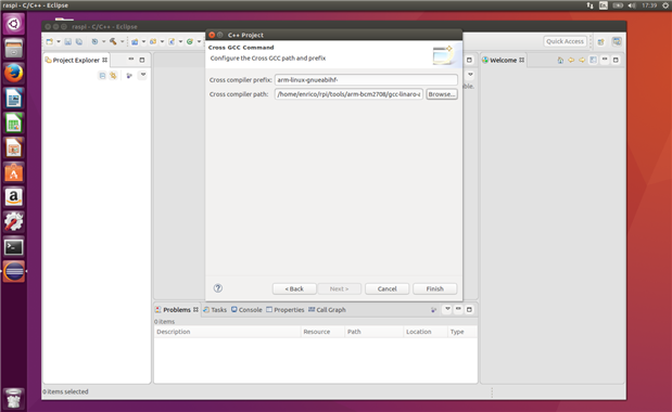

In the cross compiler prefix insert the prefix string arm-linux-gnueabihf- and in the path field insert the toolchain full path. See the images below for the described example

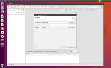

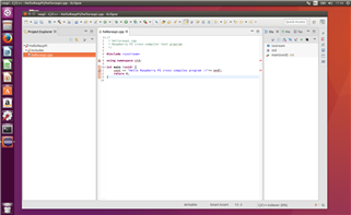

Press the Finish button and let's go coding. Create a new .cpp source file as in the example images  below
Complete the source file creation with the Finish button and copy and paste the following simple source:
 * helloraspi.cpp
 * Raspberry PI cross-compiler test prgoram
#include <iostream>
using namespace std;
int main (void) {
    cout << "Hello Raspberry PI cross compiles program :)"<< endl;
    return 0;

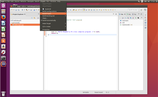

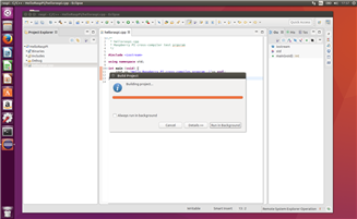

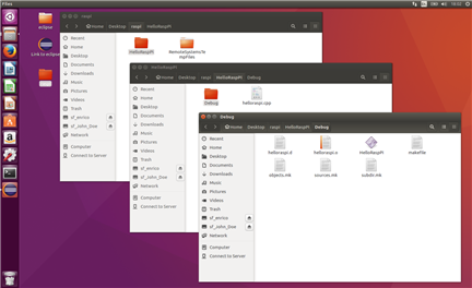

Build the project as shown in the images below
At this point in the Workspace project folder we should have a Debug folder with the compiled executable.

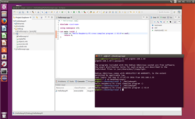

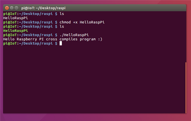

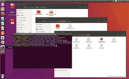

As shown in the images below, if you try to launch the HelloRaspPi program from the Ubuntu terminal you get an Exec format error This is normal, because we have cross compiled the program for the Arm Raspberry PI platform and not for the Intel Linux Ubuntu platform! Instead if you type the command file HelloRaspPi you can get information on the cross compiled application enabled to run on Arm Linux machines.
How can we run the program on the Raspberry PI ? The fastest way for now is copying the binary file on a USB pen and transfer it to the Raspberry.
After copying the complied program HelloRaspPi in a newly created folder on the Raspberry PI  As you can see in the image below, after assigning the executable attributes with the chmod command the program executes correctly on the Raspberry PI.

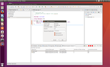

To setup the target Raspberry PI machine the only thing you need is to know the IP: the target device should be accessible by the desktop environment where the Eclipse cross compiler IDE runs via SSH.
All the other settings should be done in the Eclipse IDE environment.

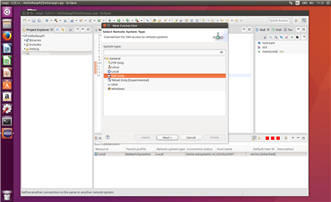

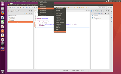

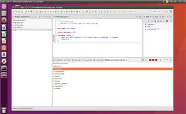

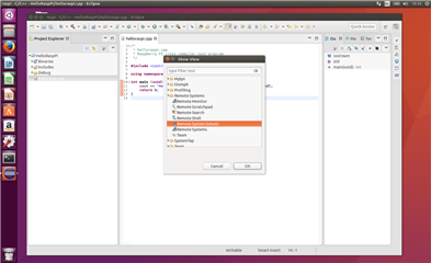

Defining the remotes in Eclipse

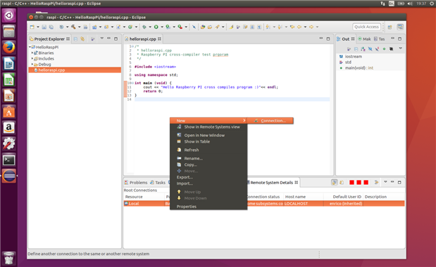

The above images shows how to open the remote systems view in the Eclipse IDE perspective you are currently using. From the possible views, select the Remote Systems group and then Remote System Details. The Eclipse IDE at this point shows to the bottom a new view. The only element in the view is local corresponding to the computer running Eclipse. Right click the mouse on the list area and from the contextual menu select New - Connection.

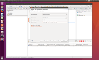

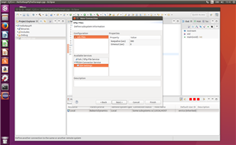

Eclipse will show now the first dialog with the connection details. For the Raspberry PI we should select the following steps in the wizard:

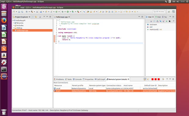

When you press Finish a new device appears in the list.
Note that the Raspberry PI IP addrress and the remote connection name are referred to this example. You should insert the correct IP address of your remote Raspberry PI.
As explained by the above images, the first time you try to open the remote resource you are asked for the SSH user and password. It's up to you to save the user and/or the password for future uses or not.

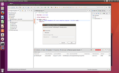

Deplyoing the last compiled program remotely
When the environment settings are finished it is extremely easy to deploy the compiled programs to the raspberry PI, test them immediately and return to editing in seconds. Just compile and point-and-drag the binary in the desired remote folder. Then switch to the SSH terminal and run it.
