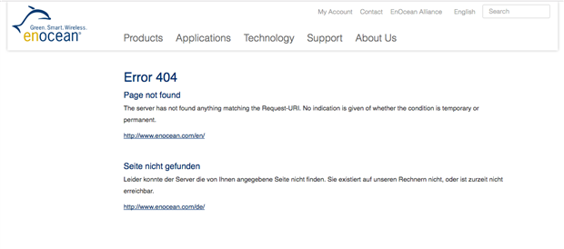

Finding this document is not so easy: go to the Pi IoT - Smarter Spaces with Raspberry Pi 3: The Kit- UPDATED! showing the list of the components of the kit, including the EnOcean Pi. Clicking on the product in the list (the buy link) you see the documents in the datasheet tab. At that point you can select the Element14 technical page link: 868 MHz Transceiver module for Raspberry Pi using EnOcean TCM 310
This sounds well structured and in the download area you can download the Gateway firmware zip file. Sadly the image below shows the landing page I have reached from this link.
It is mentioned the Gateway firmware download; as firmware I expect the software that in some way will be installed updating the microcontroller or similar (in this case the Atmel micro on board of the EnOcean PI device) The journey trying to find some kind of useful software ended on the Error 404 page; but the article also includes a link to download the EnOcean Link library. For some reasonI have not found any other way to get the link and download the library then this way. After downloading the library, the rest of the documentation seems too outdated to setup a development environment.

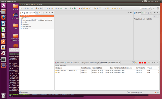

Before starting compiling we should prepare the EOLink package for the Eclipse IDE.
You do not need to decompress che zip package after download. Just copy it somewhere on your development desktop (I have placed it on the Ubuntu Desktop folder.

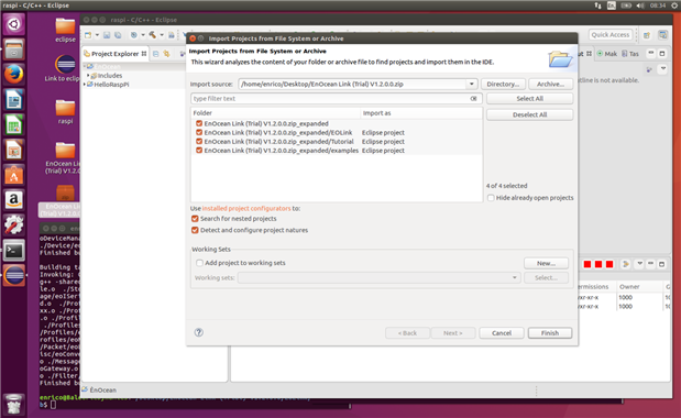

Importing the EOLink in Eclipse

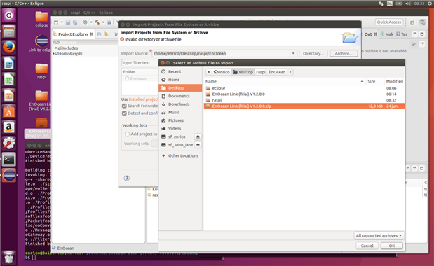

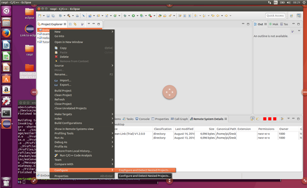

First we should import the projects in the EOLink library package as Eclipse projects.
From the Eclipse worksspace Project Explorer right click in the project area and select configure to detect new projects (see the image above)
Then select in the dialog wizard Import Projects from File System or Archive (we will use the archived zipped package) browsing to the EOLink zipped folder.
After selecting the zip file you see all the included Eclipse projects.
Select all the proposed projects. The first in the list is the zipped file with the _expanded suffix: it is the folder where Eclipse unzip the package to make the content available for working
At the end of this operation as show in the above image your workspace will include three new projects:
  1. EOLink - The library tree
  2. examples - The examples set
  3. Tutorial - The library tutorials

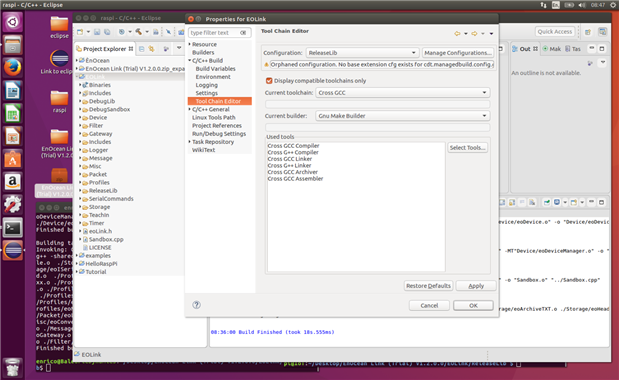

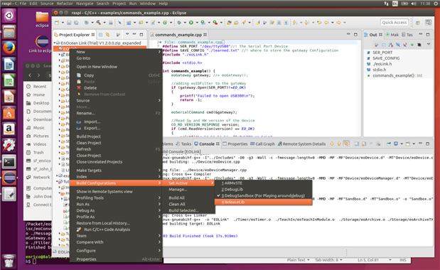

Every project includes some different configurations; ignore the Eclipse build all features! We should setup every build configuration for our usage
As shown in the image below right click on the desired project (in this case the EOLink library) and from the Build Configurations contextual menu select Set Active then the desired build configuration from the list. These settings involves the compile and link choices for the project and are independent by any source modification we will apply in future. The Build configuration settings should be applied once as the projects are newly imported; You should remember to make the same changes to any build configuration you will use in future for any project that should be cross compiled for the Raspberry PI.
Setting the cross compiling options for the selected build
As shown in the above image after the desired build configuration has been selected from the project properties you should select the Cross GCC toolchain in the Tool Chain Editor option.

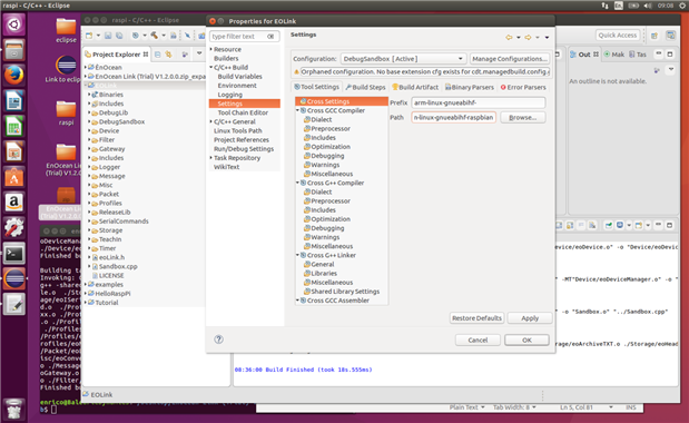

Then, from the same dialog window, in the Setting option select the ToolSettings tab and the first element in the folder list Cross Settings. You should introduce the cross compiler prefix and the full path folder where it is installed in your machine. Accordingly with the previous post indications the two parameters should be:
Prefix settings : arm-linux-gnueabihf-
Path: ~/rpi/tools/arm-bcm2708/gcc-linaro-arm-linux-gnueabihf-raspbian

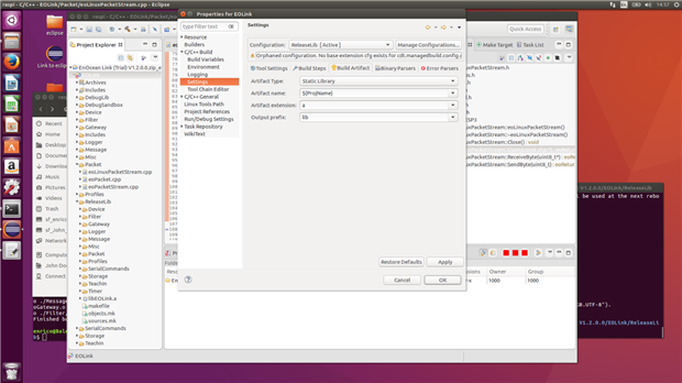

Special case: the EOLink library
These setting should be applied only to the EOLink project: This is not an executable program but it is the static library linked by any program that should use the EOLink library. Before compiling the library, from the Settings option you should also go to the Build Artifact selecting  Type, name, extension and output prefix as shown in the image below.

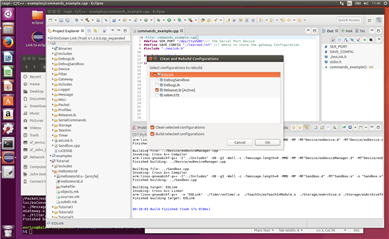

Build the library project

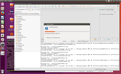

To build the desired project (in this case the EOLink library) we should just Clean and Build the selected build configuration. Also this option is accessible from the project contextual menu.
At the end of the cross-compile process We will find the libEOLink.a static library in the project ReleaseLib folder. At this point we are ready for compiling the desired tutorial and example we see in the other two project trees.
