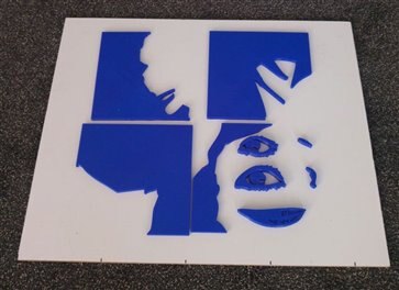

The name originates joining the two words Art and Animatronic. Based on an original opera of the digital artist Lorenzo P. Merlo, I have further processed the opera to make it animated. The final goal is to empower the image components of a visual-art image making it a series of solid parts linked together that can be touched as well as viewed.

  • Crop the image to reduce its original proportions to a square size 30x30 cm
  • Monochrome image As the components will be 3D printed, we decided to adopt two colours only
  • Catching the image essential elements the final one should be simplified due the limitations of the adopted production technology.
The image processing has been done with Adobe Photoshop CS5

The image size is be 30x30 cm but the available 3D printer has a maximum printable area limited to 19x20 cm. To create the printable parts the image has been divided in four identical squares (15x15 cm).
Note that there are seven different parts as eyes, nose and lips will be moved independently.

Before creating the entire mechanics to make the Art-a-tronic live I proceeded generating a simplified proof of concept including only the black components of the image. Every element has been fixed to a thickness of 5 mm. with the eyes and the lips more prominent than the hairs components.

3D printing the proof of concept
The rendered images with a lateral light the effect sounds good so the further step is to see if we can represent the same effect in the real world.
Some information on the printing parameters
  • Filament: PLA deep blue
  • Filament diameter: 1.75 mm
  • Nozzle diameter: 0.4 mm
  • Layers Thickness: 0.2 mm
The images below shows the results obtained. It is the worth to turn the page and move to design the mechanics of the movement.
