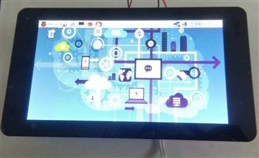

Touch screen integration
We will include the touch screen from the kit: '7" Touchscreen Display'. Luckily, this very same elemet14 page offers a very complete description of the product and how to get started image
Raspberry Pi 7” Touchscreen Display
The main steps:

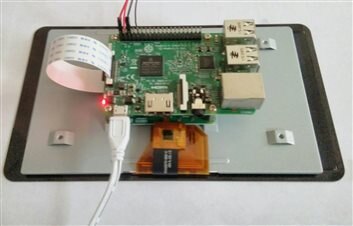

1. In the Raspberry Pi 3,  install the matchbox-keyboard (no more need of a keyboard connected via USB)
2. Do the hardware connections (we continue from step 5: attaching the DSI ribbon and then the 5V and GND jumper wires). Then, mount the Raspi to the back of the display.
Here is the final result in my case

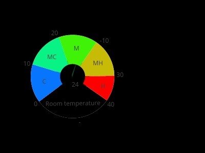

Initial approach for the temperature gauges - Plotly (FAILED)
Plotly is a powerful online tool to generate online graphs and dashboards. It gives enough freedom when creating this charts, and the additional option of exporting to a local directory. I decided to use it to generate a temperature graph which could be updated both in the central node and for a more remote solution. However, I realized this will not work for my case (see the end of this section for a dramatic outcome).
Using plotly
I created a new account in their webpage (as a free user) and started playing. Each account comes with a username and a key, which has to be included in the code using the platform or the environment.
INSTALLING PLOTTING IN CENTRAL NODE:
There are two main steps while installing plotly: installation of python library and authentication. The corresponding commands are:
To install the library:
pip install plotly
To authenticate, we have to start python, with the console command
python
There, the authentication process only requires two commands:
import plotly
plotly.tools.set_credentials_file(username='DemoAccount', api_key='lr1c37zw81')
(Another option is to include this authentication process in the python files using plotly)
Now, our python scripts are ready to use Plotly!
GENERATING TEMPERATURE GAUGE
I included the gauge.py file in the project, which can generate different temp graph with small modifications. The code defines a chart, with different temperature regions (and some missplacement in the numbers :3, something to fix if using plotly). Depending on the temperature, we should see the pointer signaling the right section. Some examples:
The limits of plotly free account
After the setup and development, I could generate an image with any new temperature sample that emulated the effect of thermometer indicator. Nevertheless, the program will crash after a certain time without any chances of recovery. It is a bit embarrassing, but it took me a long time to realize why:
Free accounts have a limit of requests (kind of obvious). 30 request per hour and a maximum of 50 requests per day. I want to refresh the GUI in a regular basis, and, even if I can regulate and minimize the number of request, I would prefer finding another solution. For now, though, I will keep the static temperature image in the GUI (until I design a better solution!).

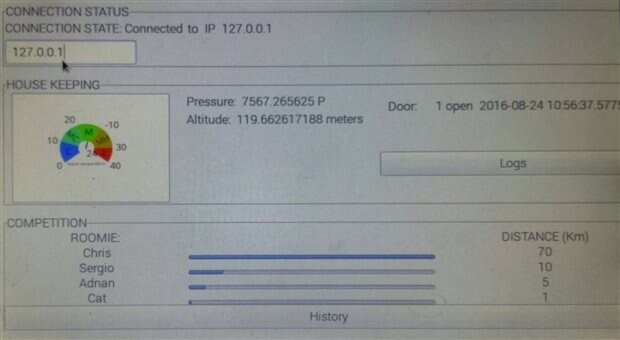

A single interface for the smart house and competition system
This interface has three frames:
1. CONNECTION STATUS
     Shows whether we are connected to the broker and which local IP we are using
     If connection was not established, we can enter and try a different local IP
2. SMART HOUSE
     Displays:
  • Temperature as a gauge
  • Pressure and altitude values in real time
  • Door state and alarm
There is a Log button, which will be used to retrieve past data
3. COMPETITION SYSTEM
     Shows a table with the residents and state of the competition
     Results are ordered, with the winning contestants on top
There is a History button, to be used to show past months results.
(*) We have only mock values so far. The real information will be read from our database once the competition system is implemented.

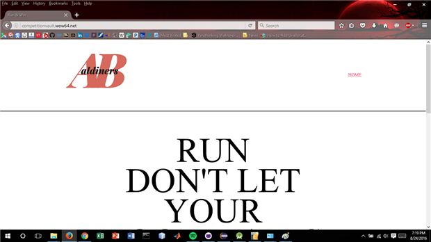

At this point, we can access our web portal using the local IP for the Central node. In the end, we want the web server to be accessible from the outside (it will manage the remote functions). There are two steps needed still:
  1. Port forwarding to our Raspberry Pi 3- the router will redirect the traffic that comes through an specific port to out Central Node. This process depends on the router itself (lucky enough, there are usually plenty of Google entries on how to), but usually there is a "Port Forwarding" menu when accessing the advanced options of the router. Two things we need to keep in mind:
    • External IP address & Start/End Port - which represents the IP address and Port to be access from the outside(START PORT). I leave the IP address to 0.0.0.0 and select an start port (will use it again when sending data to the central node from the competition mobile app) which is the same as the end port
    • Internal IP address & Start/End Port - This Internal IP address should be the local IP of the central node and the start/end port that of the service.
          We will be using this EXTERNAL IP PORT from the mobile application managing the "Competition application" in order to send data back home.
     2. Obtaining a domain - instead of using the IP address, the web will be accessible  using DNS. I obtain the domain from Absolutely Free Dynamic DNS / DDNS (the same page recognizes the public IP of your house network). No more IP memorizing for a while image
For an initial web portal we will just forward the port 80 (both, for the external IP and the internal IP). And here it comes!
http://competitionvault.wow64.net/
(Yes, yes... it is still a mock portal)
