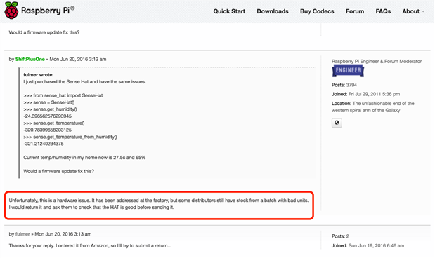

    According to https://www.raspberrypi.org/forums/viewtopic.php?f=104&t=148103&start=50 it is most likely a HW issue. I'll check mine later today ... Frederick Edit: Quickly plugged it in and copy/pasted…

    Confirmed as HW issue on RPi forums. Some distributors may have stock of faulty units, so that's what we're probably suffering from ... element14Dave https://www.raspberrypi.org/forums/viewtopic.php?f…

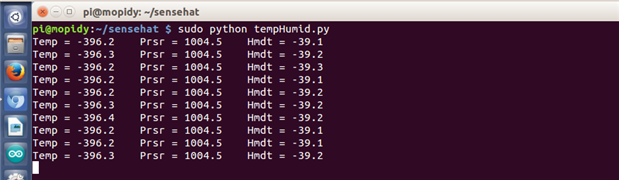

    element14Dave , fvan and vish - look like the sense hat is behaving erratically for me as well image..
    Here is screenshot, running vish  sample code above..image
