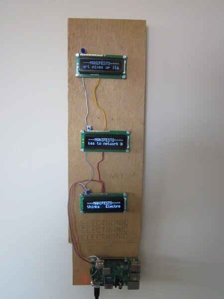

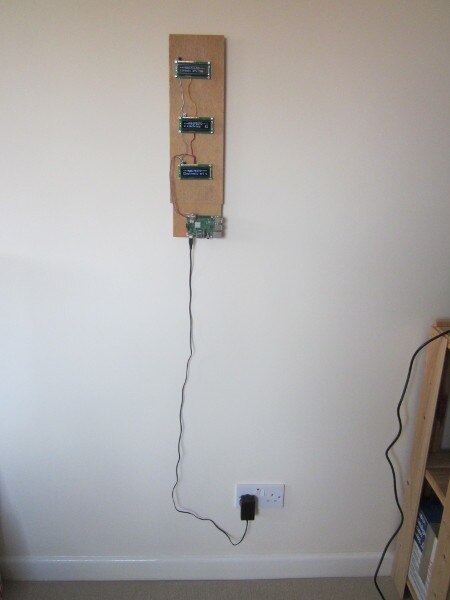

Here are a couple of pictures of it on the wall of my workroom.

Here's one display running for a while so you can get a flavour of the manifesto
It would be interesting, in a gallery setting, to see just how long viewers stood in front of it
reading the text before they got bored and wandered off.

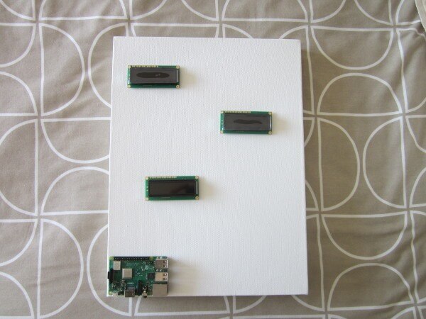

Here are my starting materials. A Pi 3 B+, three LCDs, and a canvas.
Before I worry about the art stuff, I need to get the Pi talking to the displays on the bench and get
the code sorted out.

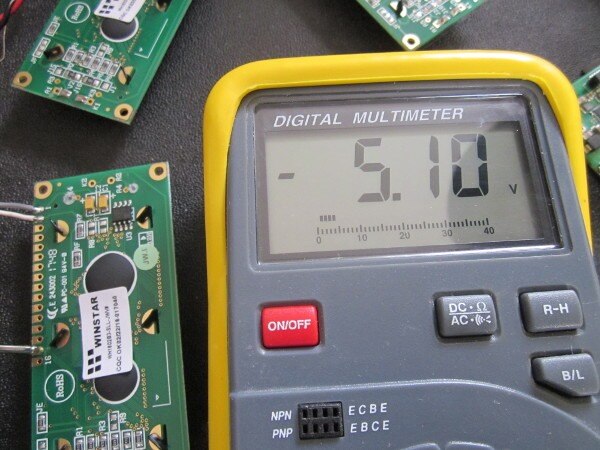

It looks like there's an on-board generator for a negative supply for the LCD voltage and the voltage
comes out on pin 15. Sometimes that pin is used for the anodes of the backlight LEDs, so I'm going to
have to be cautious - the voltage inverter won't be too happy if I short its output to something else.
Here's the panel with a 5.1V supply connected to pins 1 (GND) and 2 (+5V) and you can see from the
meter that the panel generates -5.1V on pin 15.
That's being done by the small 8-pin package that you can see on the back of the board and the two
tants. That -5V will have go to one end of a trimmer pot, with +5V at the other end, and the slider
going to the Vo supply input in order to bias the panel and adjust the contrast. The LCD part of the
panel works relative to the +5V supply, so the trimmer slider will be slightly negative to give the
recommended voltage for the LCD supply.

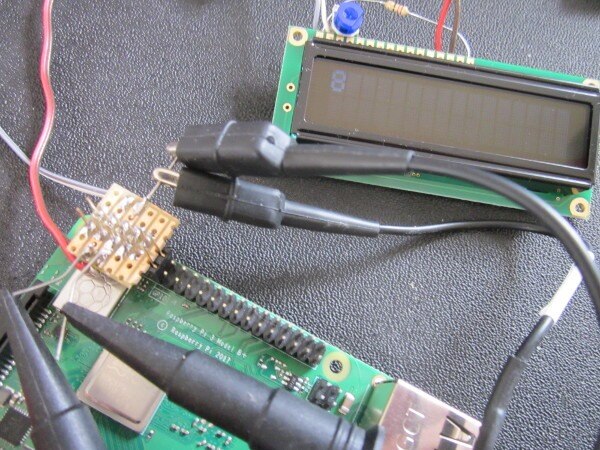

Although the pinout doesn't show the I2C address lines, they are mentioned later in the text which
also identifies the clock and data pins which are the other way round to those on the datasheet pinout
(which are for SPI). So next I'm going to connect the panel as I think the interface should go and see
if the Pi can talk to it and get acknowledges back. I'm going to leave the backlight for now and come
back to it at the end.

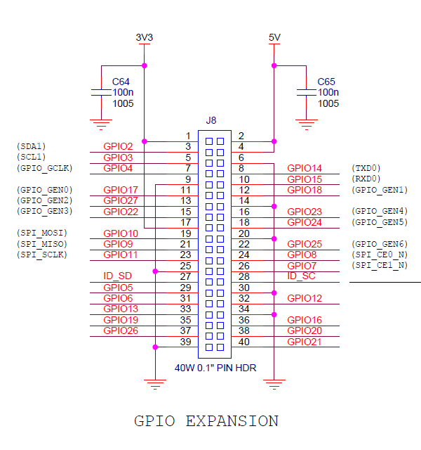

To work out where to connect it to on the Pi expansion header, I'm using this drawing. It's part of
the reduced schematic for the Pi from the Raspberry Pi website. That shows the power pins and the I2C
connections, which is all I need this time round. Although the Pi IO operates on 3.3V and the LCD on
5V, with the SDA and SCL lines I should be ok just connecting them together as the pull-ups are on the
Pi side of things.
You'd think the software side of driving I2C on a Pi would be very easy, but all the information about
it is very confusing so this just represents the point I've reached with it and shouldn't be taken as
a how-to tutorial.
It seems that the actual low-level code to drive the I2C is built into the kernal as it gets used to
control devices in the system under the guise of SMBus. To reach it from Python we need something to
include in the code that allows us to talk to those routines. Many examples on the web use python-
smbus, which is a separate C module. That needs to be installed - Python couldn't find it when I tried
including it.
After a bit of searching, I came across these bindings as an alternative
https://github.com/kplindegaard/smbus2
unlike the smbus module, where the bindings are done with separate C code, this is done with pure
Python. That makes it easier for me to install on my headless Pi because I can just copy the file that
does the work across the network from a laptop to my home directory on the Pi.

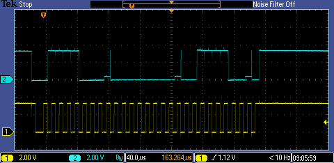

After a bit of fiddling about, I got these waveforms on the SDA and SCL lines. That shows the Pi
sending a command (3 bytes in total) to the LCD. I don't have a visible display yet, however you can
see that the panel is responding by the ack at the end of each byte being sent (the ack is slightly
raised up in the air because the MOSFET on the panel is a bit weedy - it's fine for an ack, though: if
the Pi didn't like it, it would stop at that point and not do the rest).
It also means I'm ok with the Pi's 3.3V pull-ups on the I2C driving the +5V panel.

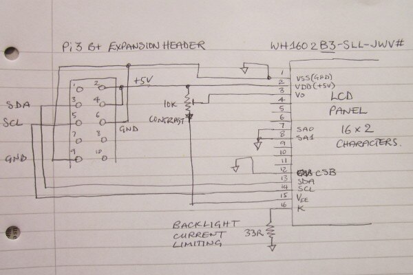

I was very unsure about the backlighting. The usual anode connection is missing as it's been replaced
by the LCD bias voltage. Measuring with a meter, it turned out that the anodes had the +5V supply on
them, so the intention is obviously to put the current limiting resistor in series with the cathode
connnection to pin 16, rather than take it straight to ground. That works ok and, after adjusting the
contrast pot, I can now see a single character that I've written to the display.
Here it is. The displayed digit is a bit dim because I was being very cautious and the LED current is
limited to about 9mA. I've now got it counting from 0 to 9 at one second intervals, so the panel is
working reliably.
This is how I've wired it to the Pi 3 B+.
Notes:
1) this applies only to the B3 variant (I2C-only interface);
2) Vee is a -5V output from the panel that's generated from the Vdd supply. Don't connect it to
anything other than the contrast trimmer pot;
3) SA0 and SA1 set the LSBs of the I2C address. The circuit above gives a slave address of 0x3C;
4) The backlight resistor is for 60mA;
5) The panel is write-only. The only thing that comes back is the ack. That means there's no 'busy
bit' to test and the sending end has to ensure that there's time for the panel to complete a command
before sending the next.

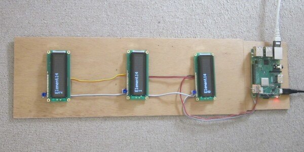

I've now wired up the three displays and the Pi. At this stage, I changed my mind about the canvas and
decided I would arrange it on an old off-cut of plywood. Not quite sure why. Might have had something
to do with looking at pictures of some early Robert Rauschenberg 'combine' pictures in a book at the
library.
That all seems fine. Here it is with the LCDs showing text. The addressing works and they can all be
written to individually - the individual digit on the bottom row is the display address.

I'm not particularly satisfied with the way it turned out - the character displays aren't ideal for
the application and the lettering on the board needs to be more prominent - but I don't have time for any more work
on it for now, so this is it as far as PiCasso is concerned.

    I liked to see several devices on an I2C bus I was aware, that it is an address bus, but never saw this use-case in real life. Do I understand correctly, that you will add 6 more pieces of Pi in future…
  • jc2048
    jc2048 over 7 years ago in reply to kiri-ll +2
    Thanks for reading the blog. Although this is about art, I'm sneaking some electronics in too. Hopefully it will be useful to anyone out there trying to use the same LCD modules. Unfortunately, no. There…
    Unfortunately, no. There are 7 more to do. I'm an engineer, so my counting numbers start with 1 (this one was just the second slice).
