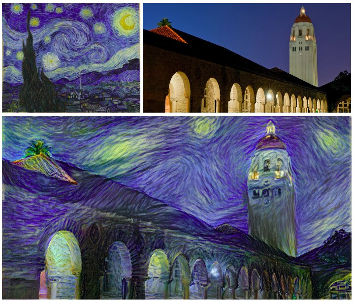

Image stylization / style transfer is a process the can be described as "extracting the style" from an image and "applying it" to a second image.
An example would be to take a painting (ex take Vincent van Gogh's The Starry Night) and apply to a photo (Stanford campus):
(example from the neural-style GitHub Repo)
