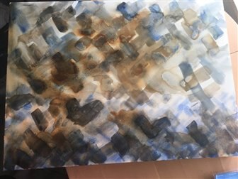

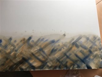

Painting the background
My most recent work involved painting the watercolor background.   I have chosen Ampersand Aquabord for this in a 22x30" size, as it is firm and will allow me to drill holes for the fiber optics, as well as for mounting the glass in front and the electronics in back.  It is a wonderful surface to use watercolor on as it keeps the colors vivid.  My conundrum is that I need the background to be dark and unobtrusive, but not too dark, as the piece will need to be attractive both during the day and night.  I was going for a neutral gray, and one way that watercolorists make gray is to use a combination of ultramarine blue and a burnt sienna.  One of the attractive qualities of aquabord is that it granulates (separates in to grains) nicely, but in this case the greys break down into the composite blues and browns. I questioned whether this would detract from the overall design, but decided to go with it.
I am painting an abstract cross-hatch pattern, as shown here in the first half of the first layer:
After the second layer:
The fused glass pieces and fiber optics will go in front of this backdrop.
