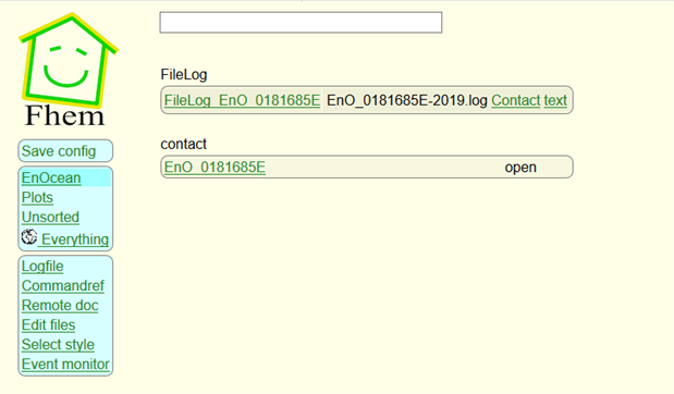

Well I had some delays with FHEM and EnoceanPi not working. I think the different landscapes with different operating systems and different versions of the Pi can make it a challenge. The Enocean Pi would not communicate with FHEM and no telegrams were being sent. I really wanted to use the Enocean sensors. The sensors require no batteries and are wireless I did look into using the PiFace Digital but the wiring was more complicated than I thought.
So I used a fresh micro SD card and installed Jessie. I used the a Raspberry Pi 3 I then followed this  I hit the learning button on the reed sensor and was finally able to get this:

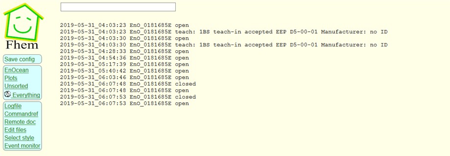

Testing the contact sensor gives these results:

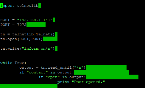

Now that I have this working I can set up the Python code to activate the Processing Sketch when the door is opened.
