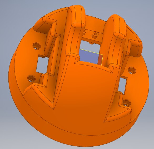

Base Top
This was one of the more complicated parts, and quite frankly I couldn't measure everything, so I had to made assumptions on how the original designer made the part. As much as I could see, it was half a sphere on top of a cylinder, and from there I went and cut out everything that was needed as well as rounding out all of the edges.
{gallery} Base Top
Top View: The top view of the 3D model
Bottom View: The shell command really made things easy here!
Back View: The back view
Top View: A lot of the edges are rounded, so I eyed out to very it looked ok to me, it won't be that accurate but I really don't need the accuracy there
Front View: The front view showing all of the different shapes of the part
Bottom View: I managed to measure the thickness of the walls at a few different places, and it seemed consistent, so I figured the original designer also used something like the shell command and just went with it
