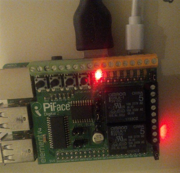

Installing:
I did a variation on the instructions to get the board working. I had to write a older version of the Operating system from 2016 to a SD card.  Using the current image , I could not find the PIFace  software to install from the current repository, You can download older versions from this link.
1. Enable SPI with the configuration tool.
2. Install PiFace Digital Software
sudo apt-get install python3-pifacedigital-emulator
sudo reboot
3. Make sure the power is off before connecting the board to the Raspberry Pi.
Testing:
1. Blinky Test
python3 /usr/share/doc/python3-pifacedigitalio/examples/blink.py
Use Ctrl + C  to stop it

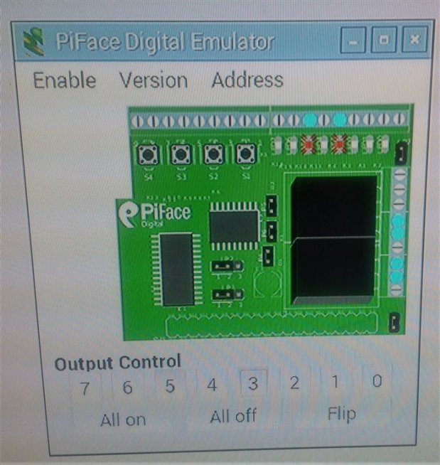

2. Emulator Test
Type in the terminal: pifacedigital-emulator or click on the desktop icon. The emulator should open and allows manual control of Outputs and Inputs. Select by clicking on Enable option.
In this example I have selected 3 and 5. The LED lights have turned on in the Emulator and the PiFace
The PiFace example directory can be found at:
cd /usr/share/doc/python3-pifacedigitalio/examples
