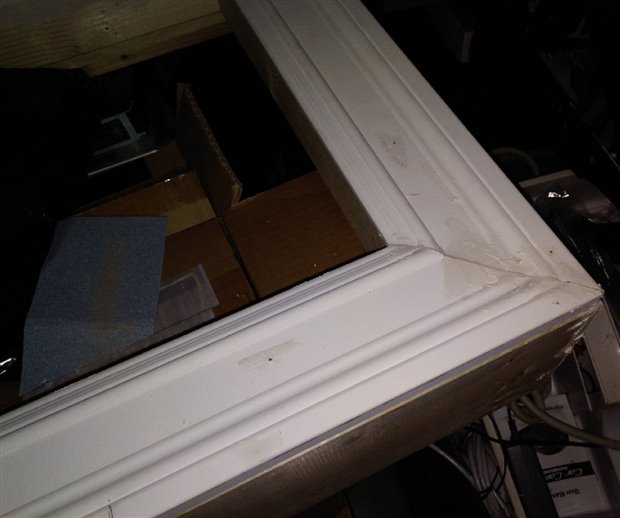

Trimmed and installed the last piece of the casement that acts as the window surround.  Added a little filler compound to make the joints seamless. Tomorrow night sand those down, and paint is on the way. I have run into a snag though. One of the display sources I was going to use was an IP security camera, but I am having problems getting the PI to login and display the stream. The camera documentation states that it supports RTSP but I have tried both Mplayer and KerberousIO and so far no success. Anyone successfully used an ESCAM IP camera with a PI?
