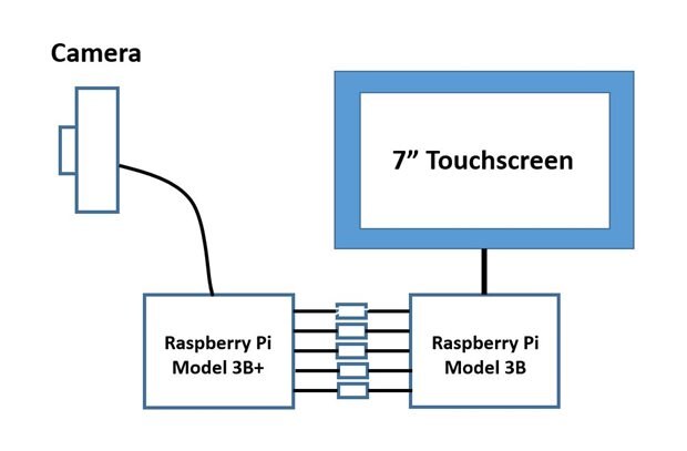

Talking Pi to Pi
Originally the connection was to be serial or perhaps Bluetooth but there are numerous GPIO that are not being used on the two computers.  Since there is a maximum of only eight faces, it is possible to dedicate one pin to each face and then set it high or low depending on whether the face has been recognized.  The resulting block diagram looks like this with one connection (plus ground) for each face between the two computers.
A resistor is placed on each line to prevent damage in the event a connection from HIGH to LOW or PWR to GND is inadvertently made.  A downside to the approach is that GPIO pin connections equal to the number of persons being recognized are being utilized and information is limited to HIGH / LOW.  On the other hand it is fast, reliable, and is easy to implement.

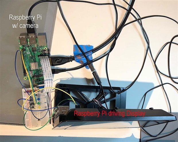

In the photo below the Raspberry Pi 3B+ with camera is on the far left and connected to a breadboard with 3 LEDs that are turned on when the Python script running OpenCV detects one of three faces.  It is also connected to the second Pi center bottom which displays the name of the person detected on the display.  Ultimately this second Raspberry Pi will create / display the art that has been selected for that particular person.

In the script running OpenCV the output is made HIGH when a face is detected and turned off on the next pass through the loop.  In the setup photographed above a separate LED flashes for each detected face and the second Raspberry Pi detects it using the same library:  The RPi.GPIO library also allows interrupts so that polling is not required.
The following video demonstrates the setup working.

If you made it this far, thanks for reading and your thoughts and comments are always appreciated.  In particular, using GPIO to communicate seems unorthodox and thoughts on that are welcome.

    genebren over 7 years ago
    Frank,
    Great update on your project.  Nice that you are making such great progress.  When defining an interface between computers there is no right or wrong way.  The GPIO looks like it will work fine.  In the future, if you have more recognizable subjects, you could easily convert your 'one pin per person' to a 8-bit number and be able to identify up to 256 individuals.
    Keep up the good work!
