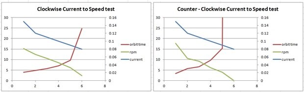

I had hoped to get a bit more data on by fan control/speed tests, but I do feel that I have a reasonably close understanding of the data.  The power supply that I was using has a pretty course setting in the area of 10ma, so there was a lot of difficulty in stepping through current limits, producing some wildly different readings as I made multiple attempts to collect the data.  There was also a bit of a difference in the speeds between the two direction (CW and CCW), which could be attributed to either the current settings, fan differences, directional changes in friction if the slip ring/test setup, etc.  Given all that, the relationship between fan current and orb speed seems to be fairly linear.
The largest difference between the two tests was the point at which 'stalling' occurred.  Clockwise, the orb continued to move at 80mA, where counter-clockwise, the orb stalled at 80mA.  Either way, I was able to achieve a 6:1 or 4:1 orb speed range, which should allow for some interesting movements.  The plan is to have a 3-axis accelerometer and magnetometer on board with each orb, so I will hopefully be able to control the fans to achieve a fixed speed, navigate to a fixed position and to detect and prevent stalling (more on this in future updates).

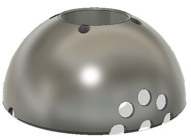

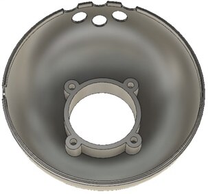

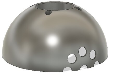

1) I wanted a cleaner design, with fewer blemishes in the orb exterior.
2) I wanted to clean up the orb interior, to make more room for electronics and to reduce any shadows due to bosses on the interior.
3) I wanted to increase the diameter of the orb a bit to again make room for more electronics and to find a good way to evenly place the LEDs inside the orb so the 'spinning effects' or 'chase patterns' would appear smoother.
So given these goals, I came up with the following designs:

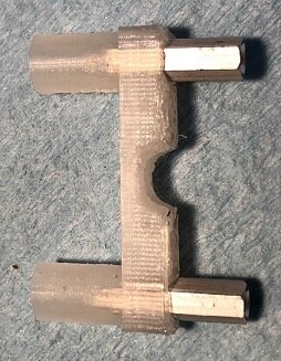

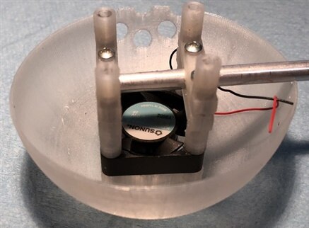

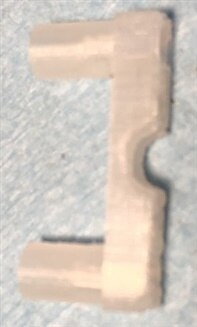

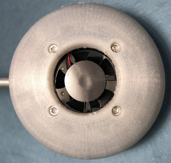

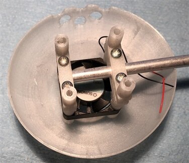

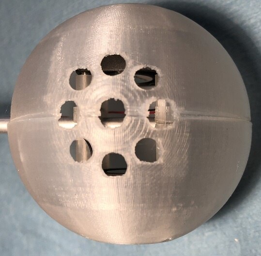

The Orb skin is thinner (0.025"), with air intake holes at the top of the orb (out of view), with only the fan mount on the interior (first three images).  The two halves of the orb interlock as the raised lip of one seats into the other half of the orb. The rod retains have hex inserts (bottom) to accept hex standoff, with a rod grip surface (with flare capture groove) to tightly grasp the aluminum support rod.  The unit assembles with 0.85" 2/56 screws, entering through the fan mounting holes and screwing into the embedded hex standoff in the rod retainer, from each side of the orb.  Here are some pictures of the parts and the assembly process.
These images show the assembly process.  The standoffs are pressed (pulled) into one side of the rod retainers (first three images).  The second half is assembled in a similar process (while capturing the support rod), and the self taping screws are attached. Then the fan screws are fed through the orb skin, through the fan mountings and threaded into the standoff (embedded in the rod support assembly).  Here are two views of the first half of the orb, with the rod support attached (last two images).

    The intake is actually on the top, with exhaust ports on either side, so they should have near equal airflow paths.  It would be interesting to try airflow modeling, but I would worry that the models of the various components might quite difficult to generate.

    There are indeed a lot of variables with air flow dynamics. With the air intake only on one side, will you not be reducing the capability of the fan and also giving it an abnormal, one-sided loading effect? I guess you could also play with the size and shape of the exhausts to compensate and change the outlet flow, although at 7 hours for printing an orb, you probably don't want to play with them too much. Any air flow modelling software out there?

    Thanks!  That is an interesting question.  I moved all of the air intake holes up to the top of the orb in an attempt to keep the sides and bottom surfaces of the orb relatively clear (minus the two huge exhaust ports).  Not that I am designing the PCBs that will go inside of the orb, I am becoming concerned about the upper PCB blocking the airflow from these intake holes.  I started with a rectangular PCB (allowing airflow between the edges of the rectangle and the orb) to a circular PCB that might completely block the airflow (although I could try to leave some open holes through the PCB to allow airflow).  Another thought is that I can continue to use the circular design, but decrease the diameter to allow air to flow along the orb walls.  Either way, there are a lot of variables that I will need to look at.  I have ordered a windspeed meter (anemometer) to allow me to measure the exhaust speed so I can tune my intake/exhaust and internal restrictions in order to achieve the best results.
