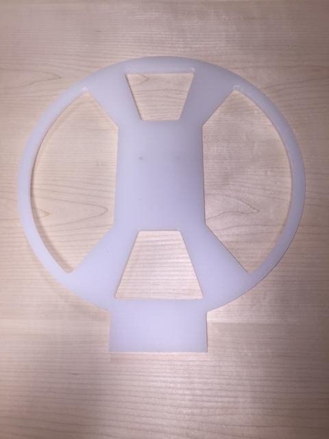

For starting the globe I had to think this in reverse "reverse engineer everything". I had to figure how many LED's I plan on using, in order to calculate the diameter of the globe. Since I am using RGB LED's I decided to use an individual addressable LED strip. This way I can make the globe bigger with more LED's which means more detail. I purchased a 1 meter strip with 144 LED's. I will be using 1/2 of the lights on 1 side of the ring and the other half to the inside. The way it will be set up I should be able to give depth to the inside of the globe. I cut the ring out of plexiglass on the CNC. If anyone wants a copy of the .dxf drawing message me and I will send it to you.
Below are photos of my progress:
Above is a picture of the .dxf drawing.
Below is a picture of the cut ring.

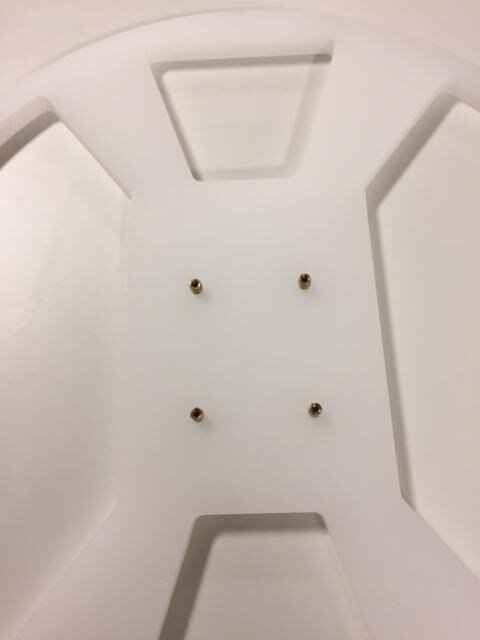

I had the CNC mark out where the mounting holes for the Raspberry Pi goes. I the drilled them and put in standoffs to mount the Pi.

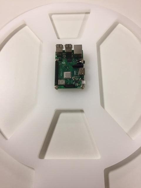

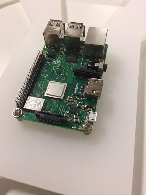

The next step was to mount the Pi.

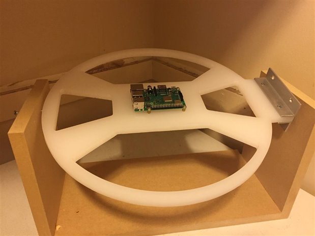

Having laid out the holes on AutoCad it made it easy to centre the Pi so it would be centred. Next I made a jig so I can hold the ring at the north and south ends and check for balance. This will have to be constantly checked, at the rotation speed, anything out of balance will destroy the project.
