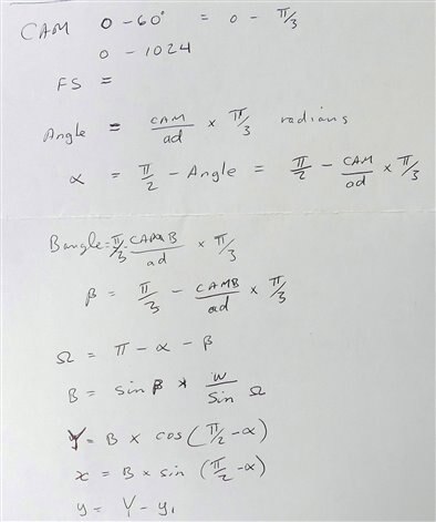

I don't have any CAD software that can handle trigonometry but I thought I understood the geometry and trigonometry well enough to just whip up a program to translate camera data into mouse coordinates .... unh-unh ... no cigar.
I was thinking of angles in degrees and measurements in inches, but the computer was using radians and pixels. The software eventually did something cute, but not what was needed.
I then drew the geometry in Corel Draw and re-did the equations .... nada ... no luck ...  nolo contendere.
One axis seemed pretty good, but the other axis was right out to lunch.
I tried writing the equations in a document instead of the software program, to make sure they were right, but they became confusing.
I eventually had to resort to writing the equations on a piece of "PAPER"...image
They then looked so simple .....
There is some kind of lesson there....
